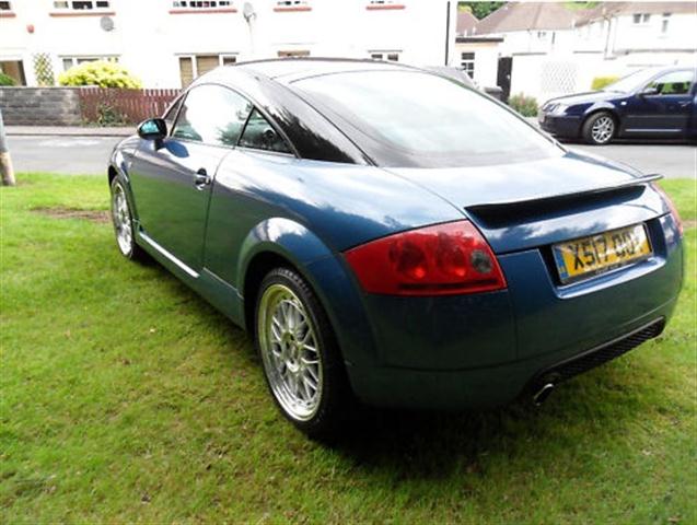

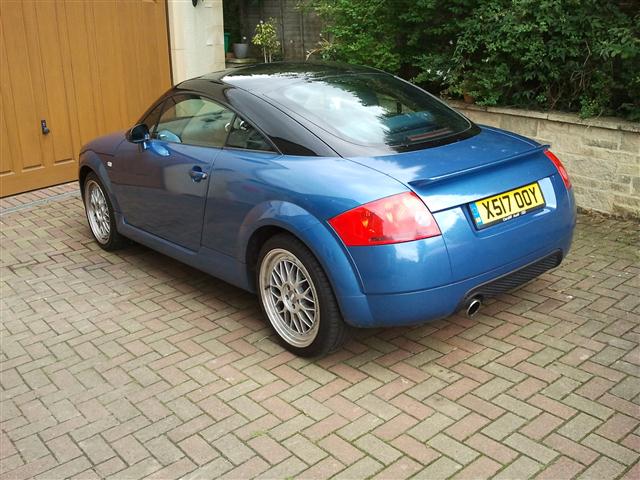

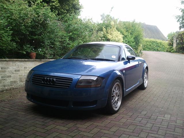

    I went out and bought a project car basically. A TT Quattro 180.
    Here it is:
    The car was bought for a steal at £2500. The whole car was blown over in April 2010 meaning the paint work is in exceptional condition.

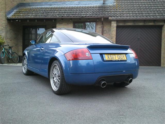

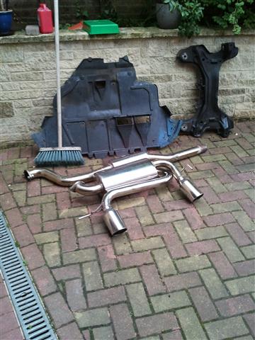

    Then fitted my new TT 225 Blue Flame full stainless 3" full system I got for it. Purchased from a mate for £150.... Now THATS a steal... lol.
    This is the system:
    Annoyingly I lost out on a twin exit rear valence on ebay, sso have had to 'Modify' mine for the time being.... It will do for now but needs doing.
    Anyway, this is the before and after:
    After:
    Mating the flange from a 2.5" system to a 3" system was a bit of a biatch.... lol.
