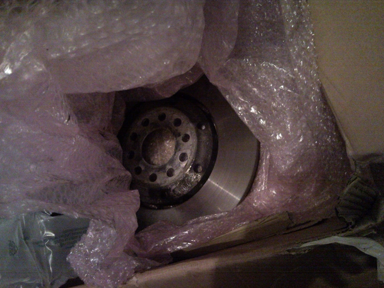

    Thought I'd post some pictures of the project so far...
    Bought B5 RS4 carriers from "Docurley". They were covered in bright red caliper paint; this had to go. So I handed them over to my mate Andy who using some nasty chemical dips and some sand blasting got them looking good as new, down to the bare metal. To prevent rust he suggested I primed them until I decided how I was going to finish them properly. So they now look like this...
    I bought a set of EBC redstuff pads and then went and picked up the complete RS4 front brake setup from "stoakseya4". It sat in my living room looking like this...
    Dust shields + extra carriers that I wasn't expecting...
    Epic discs!...

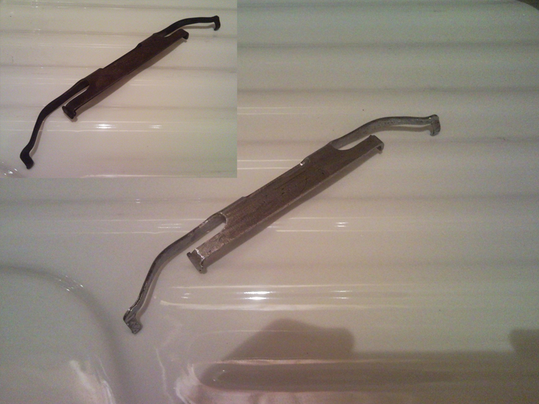

    Removed guide pins and started cleaning caliper number one in my state-of-the-art, custom made brake service station...
    And on to the second one...
    Had a fight with the rubber guide pin bushings. I had hoped to take these alive but two died in the chaos of battle. I don't actually think it is possible to remove these without cutting them out as they're held in place by toothed plastic sections that appear to be impossible to remove without destroying them. I plan on removing these plastic sections, and replacing the bushes with ones the same as used on the opposite side where these plastic parts are not required.
    I removed the pistons by blasting them with compressed air, gave everything the once over with a cloth and here's where I'm at now...
    Next job is to get the calipers and carriers powder coated (inspiration from jwhat's link).

    So rather than letting Audi screw me for some tiny pieces of rubber I sent a dust-boot, seal and one of the guide pin bushes to Bigg Red. The following day they called me to say they had matches for everything and that four of each would only be £29 + postage!! Bargain.
    I got the calipers and carriers back from my mate Andy who had sand blasted them (aluminium oxide blasted to be exact) and here's how they turned out...
    I then sent them off to my local powder coaters who said they'd do the whole lot for £30. Another bargain!?... While they had the calipers I decided to tidy up the discs and set the dremel loose on a few other bits...
    Discs before and after...
    And here's the calipers and carriers after I picked them up from the powder coaters. They were ready the next morning!! Very impressed with the service.
    So that's the basics as to what's involved in a B5 RS4 caliper refurb. Gonna put everything together tomorrow night and should hopefully be fitted Saturday.
