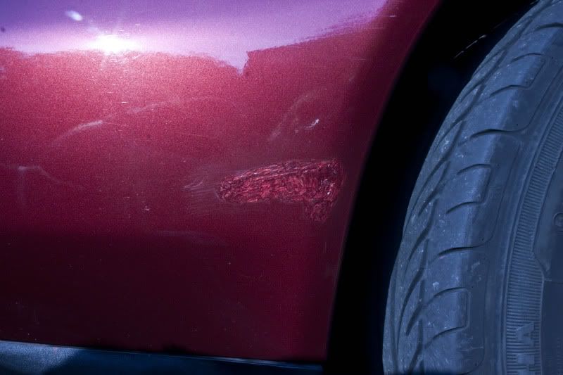

After them I decided to attempt something a bit bigger and harder
This nasty bit rubbing on the N/S/F bumper.
It was here that I remember I dont have any paint brushes. Sod it, I'm going to use something else. I thought. I only need to blob it on and sand it down. What have I got that would do the job?
O yeah, cotton wall buds. I think I had heat stroke or something cause thats a really daft idea and did not work at all.
Smearing the paint all over that area and trying to create a even coating did not work, it just blobbed up and looked *****!!
I left it to dry and proceeded to sand it down with some P2500 until I thought I make a mistake by not using a brush.
So I gave up, cleaned the area. polished it with some of that compound, then used some polish and left it like this.
Looks poo close up but from the other end of the car park you dont even notice it. It looks so much better (just dont get with in 6 feet of it.).
I left that bit for now. I will attempt it again when I have some brushes, which will be tomorrow.
