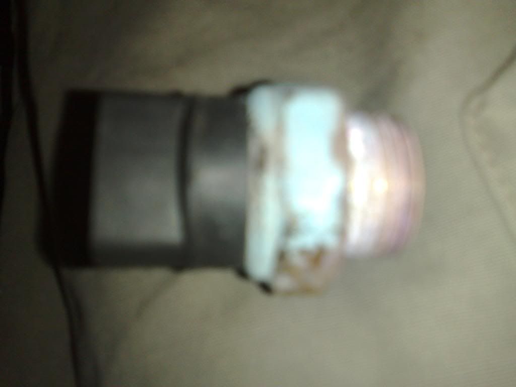

    Rad fan switch,
    The metal rear section were it actualy screwed in had come away from the rad inside and this alowed the fan switch to move and leak more and more.

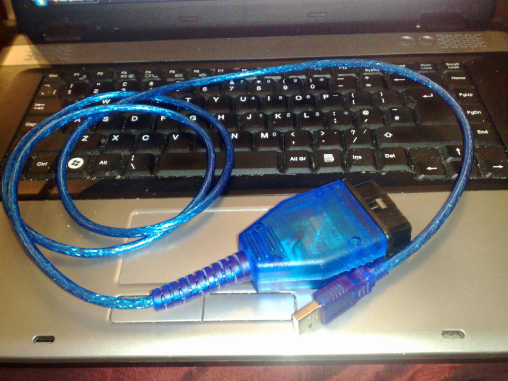

    Next thing on the list was the vag-com
    Ebay Vag-Com
    To all those who think they dont need one, I would say, "it has and is one of the best thing i have bought for the car since i got it".
    If you want to know if things are not working correctly or it just dont seem right then 12 ebay lead and free disk will give you most of the answers you may need and the guys on here will point you in the right directions

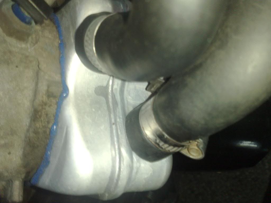

    The next thing was to look for boost leaks and then i found this:
    it was cracked on the top and the original one going by the looks, i ordered new one from Ebay, original Audi Part 25 ish.
    The pipe from the top was all split at the other end.This has all been changed with a cheap, but doing its job boost gauge top dash mounted fitted.

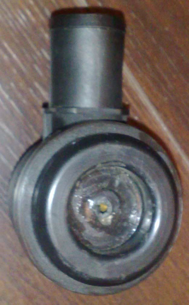

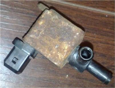

    I also ordered a new N75 because my new Vag-Com told me that was knacked so i checked the wiring{as advised on here} and they was ok so i ordered a new N75J Valve, i went for the J version in readness for the planned remap.
    This is my sorry looking old one.

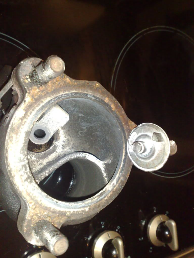

    My old Turbo back and the waste gate
    This was my old turbo back exhaust end with my waste gate valve sat on top that they found in my cat atfer I took it to get stainless decat exhaust.
    After a lot of help from some very clever people on here and I managed to make one good turbo from mine and one that i got for 20 on ebay{I know i got ripped off lol ya just cant trust some people} but worked out good in end.

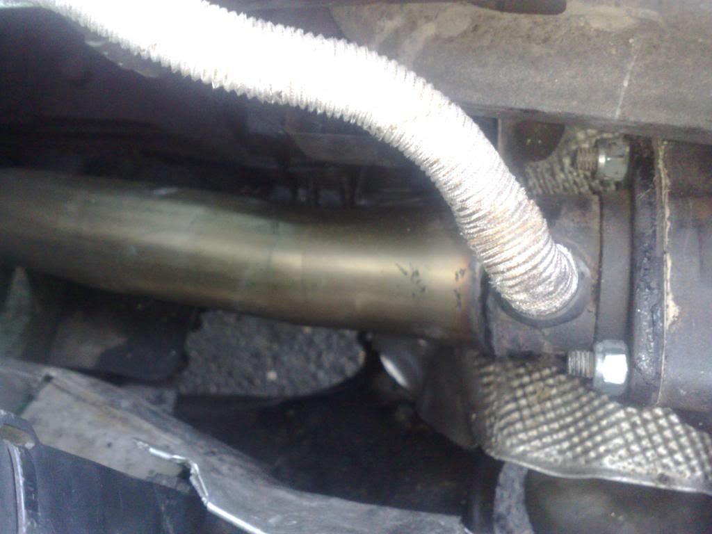

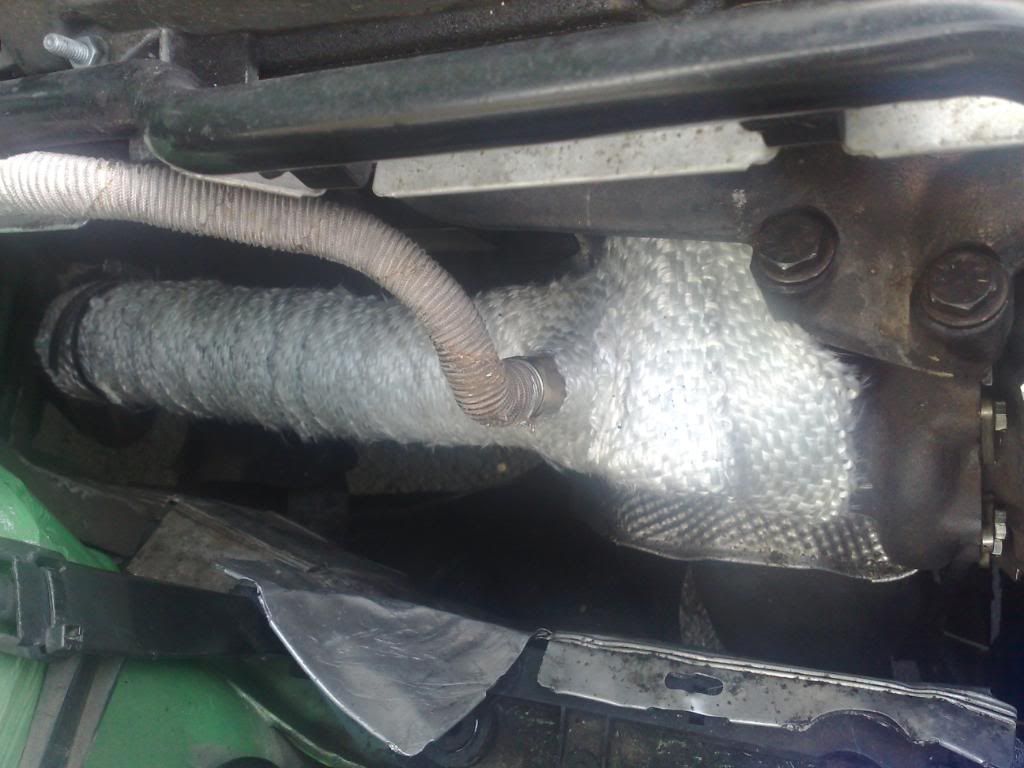

    New stainless decat pipe machine bent down to a chuncky stainless flexi pipe and goes on to the centre of the car because that was the day they found the turbo valve in the cat, i then had to go for half to save coin.
    It was suspected that the cat was blocked after suden loss of power and one night noticing the turbo and manifold glowing red hot and I mean glowing.
    I will go for the rest of the staunless sometime but its cool for now, its the first time its not blown, the front pipe was going when i got it and now nothing except free flow..
    I have also changed all the seats for some newer sport type seats in black cloth with grey-ish stripe going through them{il Get a pic on here soon lol}

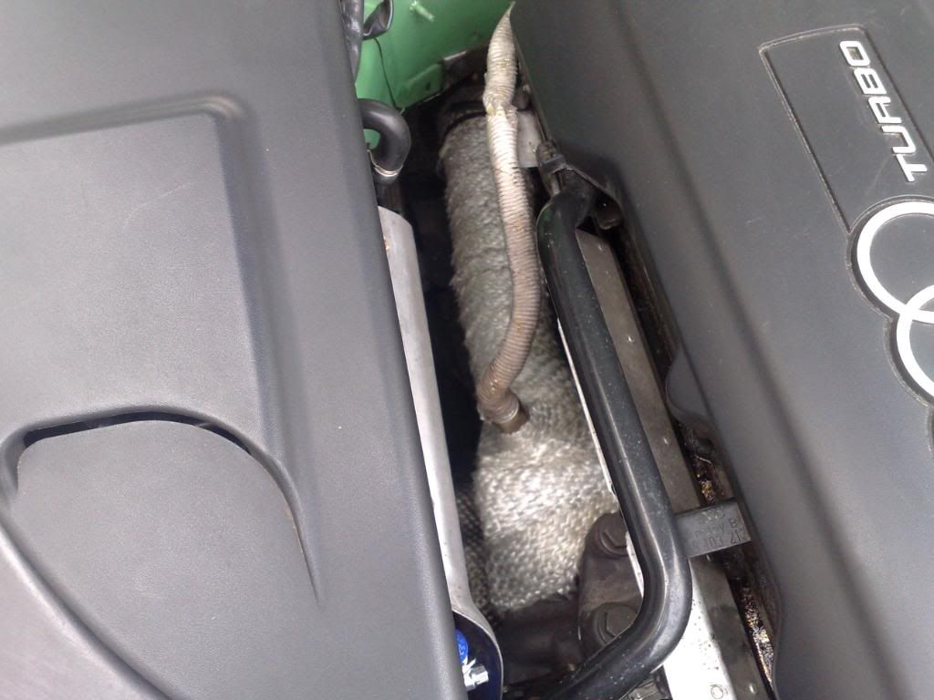

    This is the decat after i wrapped it with some heat wrap i once bought for an evo4, it works well to keep the heat down, its wrapped about 12" to 14" from the turbo rear back.
    Just wrapped decat pipe.
    All back on the car.

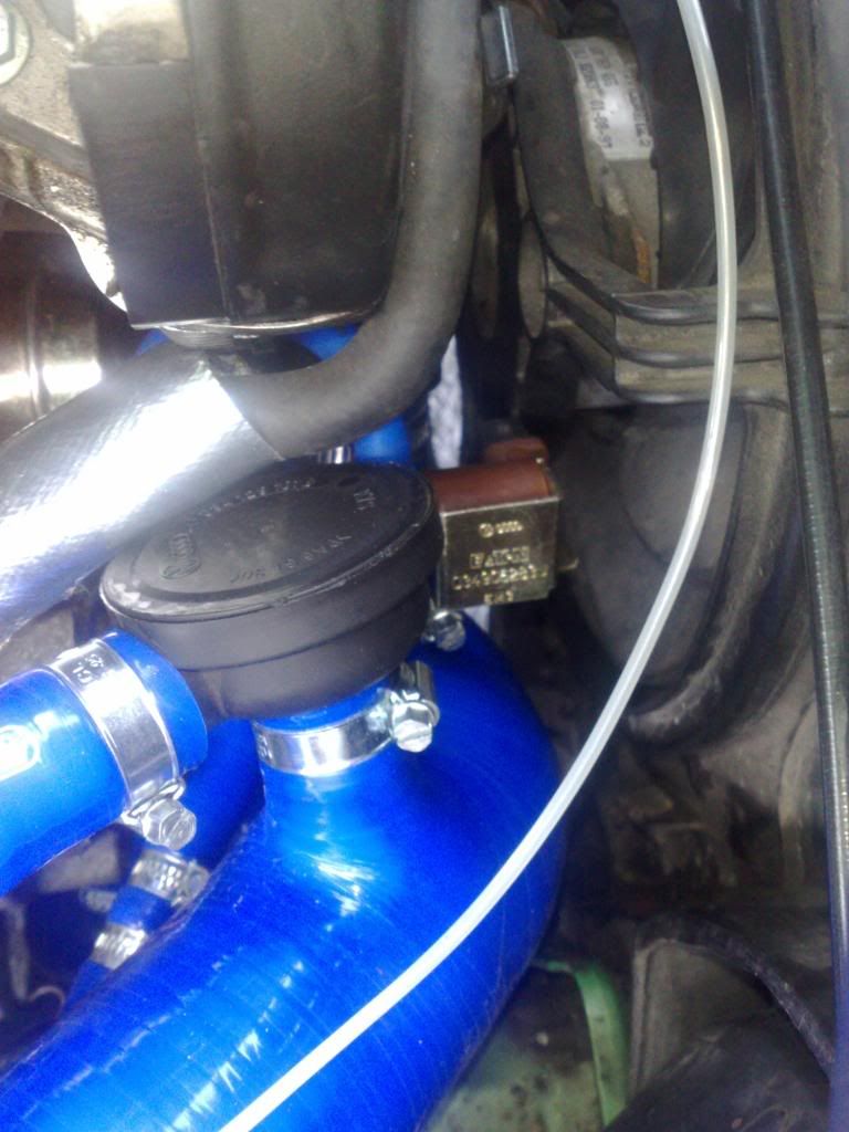

    The Samco hose kit that i talked about in Pop goes the turbo thread was also fitted at the time of doing the turbo repair.
    Intercooler pipe
    You can just see the shiny new N75 Valve snd under that is the new DV, niether of these was a big job at all, I had to extend the 2 wires for the N75 to twist were it would sit perfect with all the pipes conected to it.

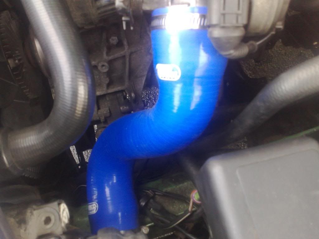

    Throtle Body hose
    Along with these all the intercooler pipes were changed to Samco hoses, some say they have to be copies for 26 per set:
    Everyone fitted perfectly very tight on and sat perfect.

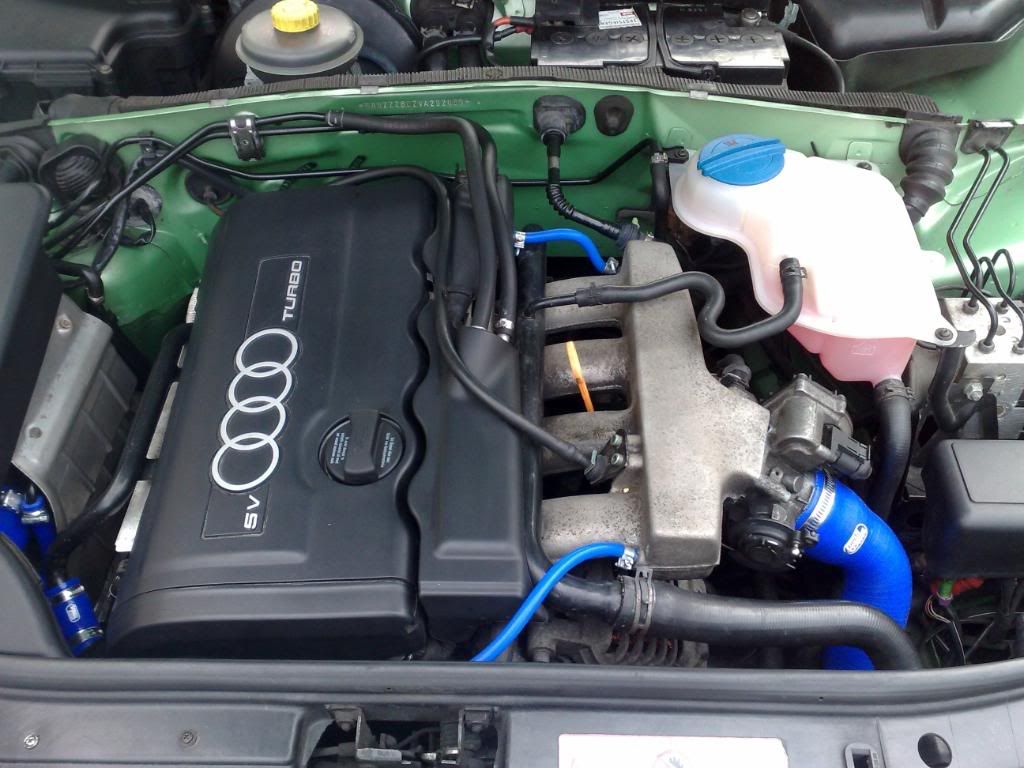

    All back on the engine and car,
    Took it for a run to warm it up and get the blood flowing round the engine again lol{been off road for 3wk ishbut started in between repairs}
    I took it for a few miles, no strange noises,creaks,scretched or anything from the engine at all, took it back home after a run out and plugged vag com into it.
    lol this was the first time i had NOT got any faults showing at all

    Took car out for another run and a little play this time and it run smooth and very quick to pull me up the speedo.

    Quote Originally Posted by aragorn View Post
    I suspect they've made a fluff of your order and sent you the complete set rather than just the TIP.
    SCORE though!
    Quite a few of the S4 chaps are using the hoses from autobahn88 which seemed pretty similar. Probably the same stuff.
    i ordered them both Kev, i just didnt expect Samco at all mate, they look and are cheep hose kits on ebay even with delivery, but it was a good score and its not just the looks because you cant see most of them lol
    it was a good time with the running issues i was having to go for the hoses to seal everything up tight and it just so happened the turbo went the week before they confirmed delivery,
    the day before i took the turbo off the hoses landed, I love it when a plan comes together just a pity the turbo had to die somewere in that plan lol
    A4 18t Avant Sport 1997, 17" chrome wheels, debagged grill, rear tints, black rear lights,
