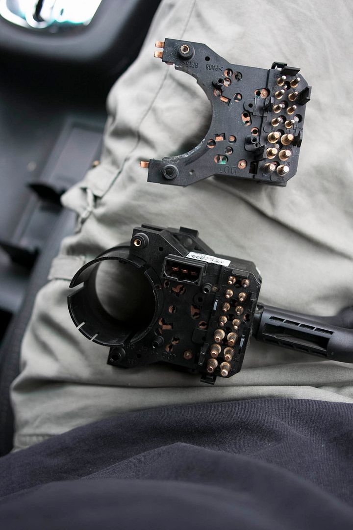

    This is the a pic of the stalk from the A8 Rev C one. the internals are the same. so no modding was needed

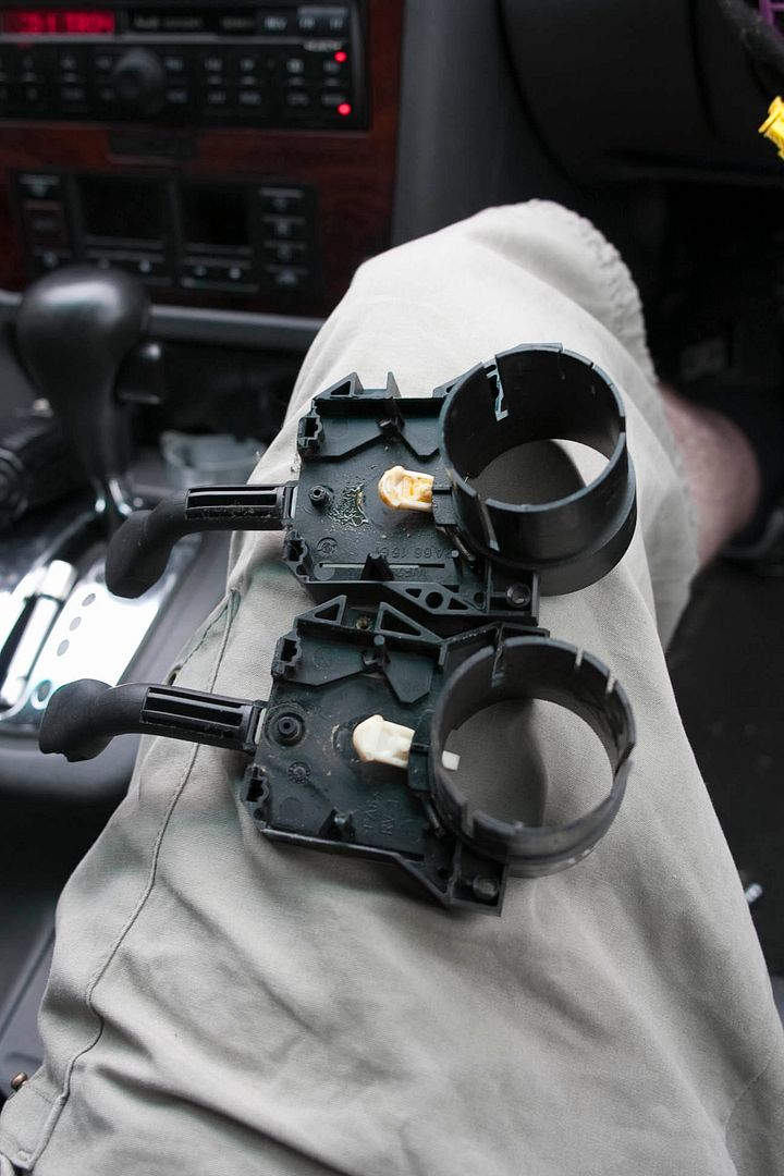

    A8 and A4 indicator cancel thingy (dont know its name) side by side.
    The A8 stalk, this is the light section. you can see the earth point at the end. Rev N dont have theses. this is the main reason for the swap.
    The back of the A8 and A4 stalks. you can see the earth points and also the screw holes that holds the cruise control plug to the stalk body.
    And it all fitted.
