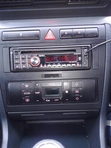

  14. #13
    ScottD3's Avatar
    Offline
    Join Date
    Nov 2010
    English Riviera
    Posts
    14,655
    A4 B5 Double Din, RNS-d, TMC, Full Sports Leather Heated with Leather Door Cards and Lower Door trims all for sale.
    Audrey's Build Thread
    RIP Audrey. She's being broken down.
    New Car, New Thread.
    Scott's Akoya Silver A8
  15. #14
    Reverse Gear
    Offline
    Join Date
    Jan 2011
    County Durham
    Posts
    22
    Sorry to hijack, but I've been looking at Becker units on the bay...
    They're all listed as BMW/Porche(sp)/Merc/Land Rover etc etc - do they all retrofit into an A4? I presume I'll need adaptors for the wiring?
    Cheers!

  20. #19
    ScottD3's Avatar
    Offline
    Join Date
    Nov 2010
    English Riviera
    Posts
    14,655
    Quote Originally Posted by griswold View Post
    I fitted a clarion in mine with new rear speakers and ran new cable to rear spkrs
    The little plastic bits on the side of the stereo, do you now if they will work pre-facelift models as well as facelift models?
    I dont really want to buy them twice.
    Quote Originally Posted by aragorn View Post
    what age/spec is your car?
    My old avant didnt have an amp at all, everything ran off the head unit.
    At some point, they moved the rear amp to the rear speaker, or in the case of avant models, added a sub and mounted the amp for the rear speakers and sub inside the sub enclosure.
    The amps are fed a line level signal from one of the mini ISO plugs on the head unit, and theres also a switched live sourced from the same place.
    All the adaptors do is stick a set of RCA's on the end of the line level wires, allowing you to plug it into the headunit, and patching an switched live into the amp from the headunits remote.
    You could do it yourself with a soldering iron in about 5mins.
    98 avant with rear sub.
    I wont buy a ISO unit i'll do it my self.
    I'll rip the back down and take a look.
  21. #20
    griswold's Avatar
    2nd Gear
    Offline
    Join Date
    Jan 2008
    Posts
    336
    The side panels it depends who sells them and if they label them correctly
    FP-05-03 is for 99-2001 and FP-05-00 is for upto 99
    they look the same so just check where you buy from if they are the right ones
