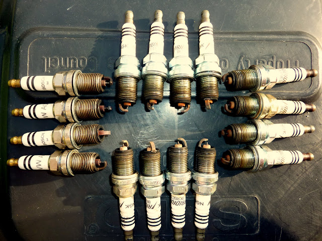

    As I went out to have a check of the car this morning I decided to have a look at the various plugs that have been in the car since it was new.
    I was hoping by performing direct comparisons on all 4 grades I might be able to learn something about the way they are coping with TFSi fuelling characteristics.
    I have used 4 plug types since having the car:
    1) Bosch platinum single electrode - OEM plug supplied from factory (In for 11k on Revo Stg1 - removed due to stutter at 5,000rpm)
    2) NGK Iridium 6 (BKR6EIX) - Recommended OEM temperature grade (in car for 15k on Revo Stg 1 - no issues, removed for stage 2)
    3) NGK Iridium 7 (BKR7EIX) - One steps colder (In car for 6k on Revo Stage 2, changed for 2+, no issues other than electrode discolouration causing concern)
    4) NGK Iridium 8 (BKR8EIX) - Two steps colder (Run for 7k on Revo Stg 2+ under duress, removed due to stuttering idle and strong smell of unburned fuel and carbonation on rear of car)
    Here is a photo of the plugs taken out of the car (anti-clockwise):
    1) OEM Bosch (Left hand side)
    2) NGK Iridium BKR6EIX (Bottom)
    3) NGK Iridium BKR8EIX (Right)
    4) NGK Iridium BKR7EIX (Top)

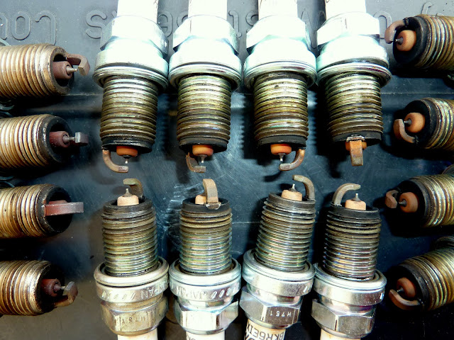

    If you look more closely at the electrodes / tips you can see from the colour of the ceramic cuffs that the plugs are obviously running at significantly different temperatures inside the chamber, and interestingly the cooler plugs are showing a much redder colour around the ceramic cuff. Whether this is stained from additives in the Shell V-Power or just running hotter I have no idea, but the NGK 6's electrode tips are much whiter (none of these plugs have been cleaned up).
    So whilst I have read there are benefits to running the cooler 7's, of all the plugs these looked the most 'scorched' plugs here (granted I've been running the 8's for less miles).
    The OEM plugs are absolutely blackened, and are the only plugs I have had outright performance issues with. The car would stutter at 5,000 rpm and there was marked pitting on the electrode tip. Supposedly according to Audi they should be good for 60k miles, not 11-12k!!! Make of that what you will.
    I hasten to add, I'm not a plug guru. This thread isn't to scare or concern anyone, it's just a purely observational thread that provides people with some photographic comparisons of plugs with comparitive mileages running in a tuned 2.0TFSi S3 engine. If we can learn anything along the way, then its all good.
    I've dropped in a set of new 6's today (I had some spare), and will monitor how things run, and I have a set of 7's winging their way to me from the interweb. I'll try and do some back to back comparisons in due course.
    Any thoughts or analysis greatly appreciated as always.
    Cheers
    Warren

    Those 6's look spot on. the 7's and 8's are both showing signs of Insulator Glazing
    Glazing appears as a yellowish, varnish-like color. And indicates that spark plug temperatures have risen suddenly during a hard, fast acceleration period. As a result, normal combustion deposits do not have an opportunity to burn off" as they normally do. Instead, they melt to form a conductive coating which will eventually cause a misfire.
    In fairness your plugs are having a hard life in your tuned engine and it dosnt surprise me the OEM plugs cant cope for long.
    Interesting pictures and they really show the difference quite well between the heat ranges. this could become a very good thread .

    I am going to run the 6's for the foreseeable future.
    I've had really mixed feedback on spark plugs. Some say that the increase boost will require a plug with a thicker ceramic collar to reduce the heat on the electrode. I have been warned if the plugs get too hot the electrode tips could drop off into the chamber.
    However, whilst I believe this may be the case for the 'old skool' turbo charging systems the TFSi system is a very different animal, and the way they system obviously mixes its fuel into the chamber means that maybe the heat issues may not be so prevolent.
    I spoke to a guy a couple of months ago at RGS Motorsport. He currently races Lotus F1 classic cars as he was a test driver for them back in the day. Really has his head screwed on, and he believes resolutely that if your engine is mapped well, even with modifications you should NOT need to deviate from the OEM plug temperature.
    I think switching from platinum electrode to iridium is not likely to cause any pain as it is just harder, and the thinner tip allows you to generate a similar spark with less strain on the already known to be weak coil packs.
    I do hope the thread generates some useful debate as I think it could be an area which is causing premature issues / knock on effects in these engines. My fear is if people take the wrong plugs for too long, are there more permanent issues being created inside the chamber (as no error codes come up until you feel there is an issue).
    I haven't driven the car since putting the 6's back in, but the idle is straight away far more consistent.

    Popped one out (!) to have a look, and for a new plug there is SHEDLOADS (and I mean shedloads) of carbon deposit on the plug body (if you look at the plug pictures above, they are all black around the solid metal body of the thread which butts into the chamber). Didn't expect it to be so pronounced in one journey.
    Too much fuelling on Revo maybe (Boost 9, Timing 5, Fuelling 8)??

    Yea i see what you are saying. I suspect its just that part of the plug is a lot colder because of the heat sink into the head. I expect it will initially coke up where it protrude into the combustion chamber but only till it seals the gap between plug and the carbon coat in the chamber. The colour of the centre ceramic is the best indicator and that looks fine on 6's.
    My knowledge doesn't really extend past motorcycles into Turbo's but the basic principles apply on plugs i think. Its quite possibly;e that a lumpy idle is an air leek somewhere. If that is the case then you need to find that before paying to much attention to the plugs as that might well effect their colour.

    hi guys ive got a 2010 audi s3 with an mtm map and also having an issue with spark plugs,
    mapped at 7k started suddering at 7300k took back under warranty had new audi plugs,at 11300
    same issue again so fitted ngk BKR7EIX lasted 2k same issue again so fitted factory ones back and took back to audi,
    was put on lap top no fault codes then sent off to audi for more extensive diag into cause,was told audi are aware of this and currently working on a solution short term fix is to fit another set!!!so on to my next set and all is ok for now!any more info call me on 07977334041 col
  28. #27
    warren_S3's Avatar
    Moderator

    Quote Originally Posted by colb1977 View Post
    I am SO pleased you have posted this, not because I want you to have an issue, but because TOO MANY people have been laying the misfire blame at Revo's door, and I've never believed that to be the case, I've ALWAYS thought it was an Audi issue.
    Halle-****1ng-lujah!!!
    This seems to be an epidemic issue which is as prevalent as the fuel pump cam follower issue / coil pack issue .......
    This is an award winning engine, and I think the combustion process is flawed. I'm tempted to have my plugs re-gapped down to 0.7 or 0.6mm from the normal 0.8mm once my car inevitably starts doing it.

    So for all those who've spent the last few weeks championing that this is a Revo specific issue...... now maybe the time to reflect and realise your trusty Audi and it's lean burn lump ain't quite as complete a product as you once thought as if it can happen with an MTM map...... Nothing is as clear cut as you may think when it comes to engines and tuning.
    Ill cue the tumbleweed for when this thread goes unresponded to, but to me it's a clear message that we're ALL treading in very unfamiliar territory where there are SO many veriables that we only partially understand. It's not our remit to point the finger at any one company until we have conducted the appropriate research and gathered clear evidence or facts before we start posting any derogatory or defamitory accusations. Yes we'll be precious because we pay out a lot of money for our cars and modifications, and yes they should just work, but we're asking a lot of what is basically a 2.0l lump pushing out in excess of 300 brake, and because these cars are subject to continual changes to meet as a minimum Euro and tax bracket thresholds the world can change and move on.
    For recommendations as to which plug to choose read this: Spark Plug recommendations for S3 8P 2.0T (OEM & modified)
    I will get mine out and change them once my new plugs turn up. Must head out and buy a feeler gauge as I've lost my old one.
    For those of you who have never gapped a plug before, here is a 'How to Guide' from NGK USA:

    Still however no one has a definitive answer on which is best.
    Ive ran the 7's and had a few dips, ran the 8s now for a bit and the dips have returned. But saying this our climate here is much much hotter than you guys over there too.
    May swap back to the 7s and see if there is any difference again.

    Quote Originally Posted by fuzion View Post
    Im convinced the answer is less in the temperature of the plug and more in the gapping of the plug but because that requires effort and tools itis largely ignored by the masses.
    My next plugs are set to 0.698mm
  34. #32

    Seems to me warren you are settling on about the recommended plug gap used by everyone in the 1960's onwards ie. .025" ( actually .0265) ish. All plugs were gapped at 25thou from mowers to race bikes, it was a std Champion gap and most feeler gauge sets had a plug gaping 25 thou blade as their largest blade. Of course then you had another factor which was the dwell angle as well ie the points gap. the wider the gap the longer the points stayed open and the more time the coil had to recharge. Anyway...I am sure anyone under 40 is getting bored now :-)
    My point is that a coil in those days would charge to about 20,000v before discharge and one of the advantages of electronic ignition was the much higher ignition coil voltage which meant you could run much wider plug gaps. The reason for this was the low gap and the high voltage meant that the point at which the spark became a flame was lower ie: lower revs. at 10000rpm a plug needs to put out a individual defined spark about 42 times per second and the smaller the gap the more likely the spark becomes a flame. Things are better today because in days gone by and engine would have 2 sets of points for 4 cylinders so the plugs would fire twice a rev once at BDC and once at TDC near enough so the plugs were firing at 80 times per second.
    My point here ( i do have oner somewhere) is you are absolutely spot on in that gap is very important, more so as you tune an engine. As turbo or compression goes up so does resistance across the air gap of the plug. Too bigger gap and you will blow the spark out at high revs, to small and you will lose the spark definition. also to a lesser extent a spark takes twice as long to jump 40 thou as 20 thou so you also alter the timing by a small amount. also you have too add in , as you are, heat as well. Because you are out of the factory comfort zone with engine and plugs experimentation is your best option so it will be interesting to see what you come up with. I was doing this with M/C drag engines 25 years ago and i am bored with it now so good luck and i will just steal your findings rather than make my own this time :-)

    I don't disagree Paddy.
    I think the thing I've noticed since running the 8P2 for 60k (40k at S2 or above) is the condition the plugs were in, and it's not that the plug is damaged in any way, it's the heavy sooting that to me says I'm sure something in the set up is not right, and having tried temperature settings 6 / 7 / 8 it only got worse with colder plugs. Stage 2+ adds 38% more BHP with the additional fuelling, extra air in and out, and to be honest on reflection I feel like a bit of a dick that I didn't think to investigate changing the plug gapping earlier given the way the car was eating plugs (plugs that could be salvaged to run a bit further with a gentle clean up).
    When the plugs look as carbon fouled as they did on some of the ones I pulled out of 8P2 something is not 100% right. I've never had a car which leaves so much carbon build up on plugs and through to the tail pipes. They were all fitted to manufacturer torque settings, and run with V-Power / overserviced etc.
    It was NGK who suggested (whilst they obviously don't recommend it), that I drop the gap to 0.6mm, so I've settle on going half way towards that on my next set of plugs to see what difference it makes. Whilst the TFSi system is advanced, unpleasant side effects of the way it runs see valve coking / sludge etc. in very young engines (as low as 20k miles). Whether this is down to the lack of a 5th injector or just running at the extremes of whats possible????
    People seem to be happy chucking in another set of plugs, then another, and another. Bunging another 50bhp at a car and then expecting it to take care of itself is at best optimisitic. It's like repeatedly sticking your arm in a lion cage and wondering this time if it wont get bitten off! My other concern is what assocaited side effects could be building up in the wings alongside this issue for later on???
