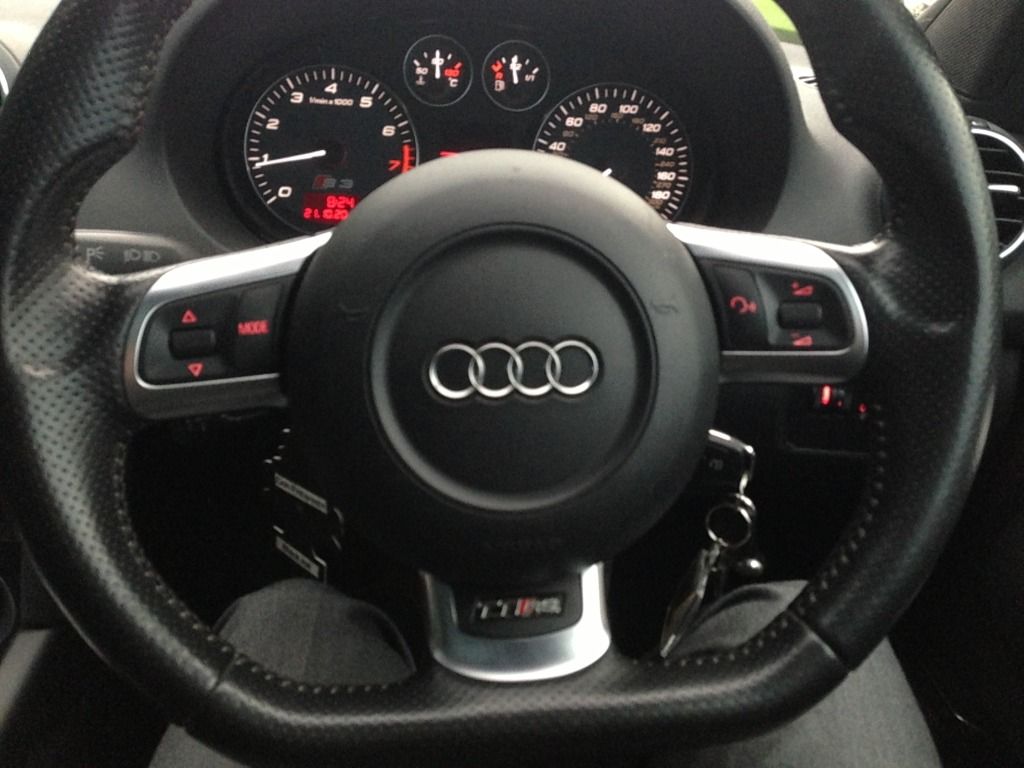

    Hi guys,
    i have made many searches on the forum but I could only find answers for the 8L steering wheel.
    I basically have the steering wheel in the image below:
    and I am wondering if it was possible to change the steering wheel badge to a S3 one?
    it currently has a TTRS badge in it from a retrofit I guess but I would like to get a S3 badge fitted.
    is this a simple job? A matter of prying out the badge? Or must I physically take the wheel apart to get to the badge?
    also does anyone have a part number for this? Or are they all the same size?
    Any information is appreciated
    Will

    I'm sure I read on another thread or Forum that you just pop out the badge with a small screwdriver, you can get S3 badges on ebay, cheaper than at Audi.

    ETKA suggests the part number as 8L0419685A.

    From memory on another thread, wheel needs to come off to gain access to the rear of the insert you require.

    I was told that you remove the air bag and carefully prise the complete 3 spoke chrome bezel off, as it holds the badge/blank. Not difficult, apparently. Use plastic trim removal tools!!!

    I also have the ttrs wheel and replaced it with a sline badge, as advised you would need to take the airbag off and take out the chrome ring which holds black badge surround and badge itself.
    When I changed to the sline badge I found that the size of the badges were different and needed the correct black surround too.
    here is the thread when I did mine, you can see down the first page where I removed the badge holder

    As advised the black backplate for ttrs badge has a wider insert gap, given S3 is shorter than TTRS, so don't forget to order this aswell as S3 or even sline badge, before removing it all.
