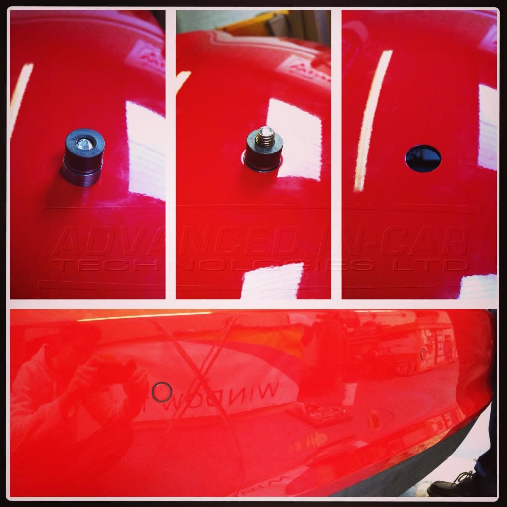

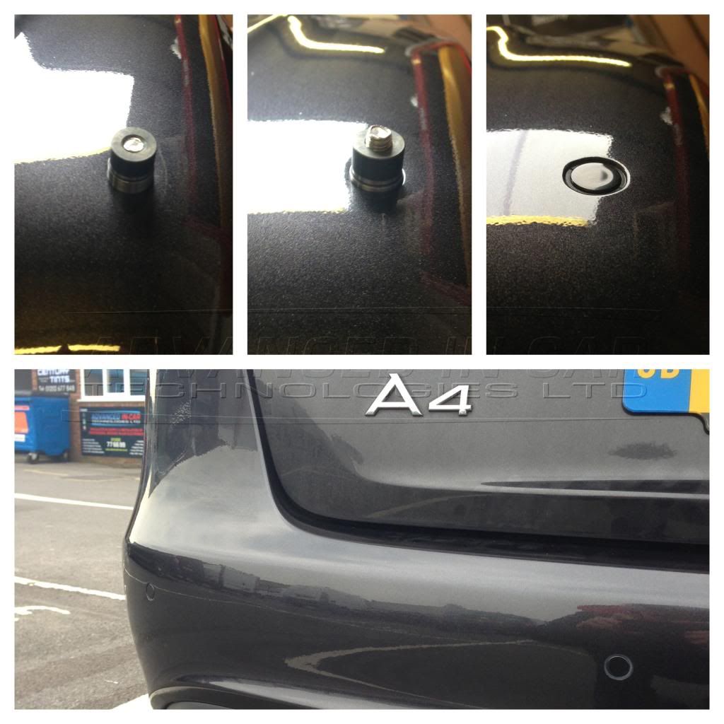

Here are two examples of some sensors we did the other week:
As you can see these use a special tool to cut the hole which pulls the paint through to give you that nice bevelled edge...
Check them out on our site if you're keen!!
