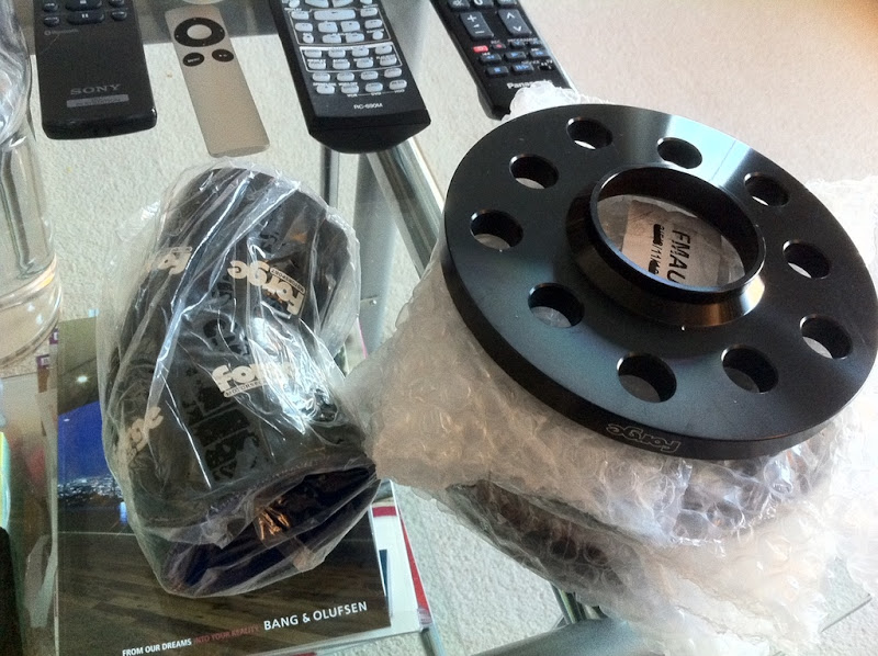

    4) SPACERS
    I'll make no secret of it; I'm not over on spending big money on a car if it doesn't improve the ride / handling / performance. I always tend to do any cosmetic tweeks last, but for some reason I just wasn't happy with a few things on the car.
    First was the wheels. I like 19's. These 18's buried under the arches just looked dreary. As winter was coming I decided to do spacers as it meant I could roll on fresh rubber with 225 rubber and have a touch more grip and compliance in the ride during the inclement weather. I also have serious misgivings about how hard the car may be on 19's given the firmer suspension, but that may have to be addressed at a later date with better springs / dampers.
    I did have a quick look at what my RS4 style 19's would look like, but I wasn't too certain they worked, so I left the 18's rotors on for now.
    Bit of wheel weight trivia for you. OEM 18" hollow spoke rotors with Bridgestone tyres are 1.5kg's heavier than aftermarket 19" RS4 replica's with Uniroyal rain tyres (both sets of tyres have 7mm of tread!). Go figure! (22.5kg for the RS4's vs nearly 24kg for the rotors).
    Spacers
    Before fitting spacers I wanted to avoid the awful rusting I'd suffered on my 8P2 car around the hubs, so I bombed down to Hellfrauds and got myself a tin of Hammerite Smooth silver paint to paint the hubs. I'm pleased to report that after 2,500 miles they are holding up well and still look clean!
    The guys at Forge hooked me up with some 11mm hubcentric spacers (F&R), and then I suffered wheel wobble issues. Thankfully it transpired that my factory fresh alloys were 35g out on one of the front wheels, and 10g out on one of the rears, and the wider track just accentuated it! One they were balanced and refitted they were spot on, so no more numb hands, and the anodised Forge spacers mean they don't end up bonding to the hub like some other brands! Beuatifully engineered and really happy with them.
    Before Spacing
    After spacing:
    UPDATE: I've been getting some rub when all seats are taken, so rear upper Torx screw has come out of rear arch liner. Yet to see if it cures the issue, so when its been tested 5 up again I will post up!
