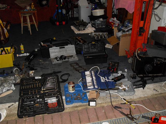

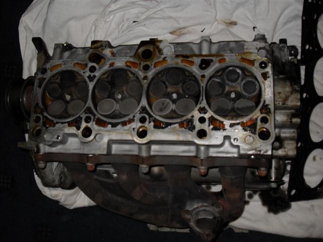

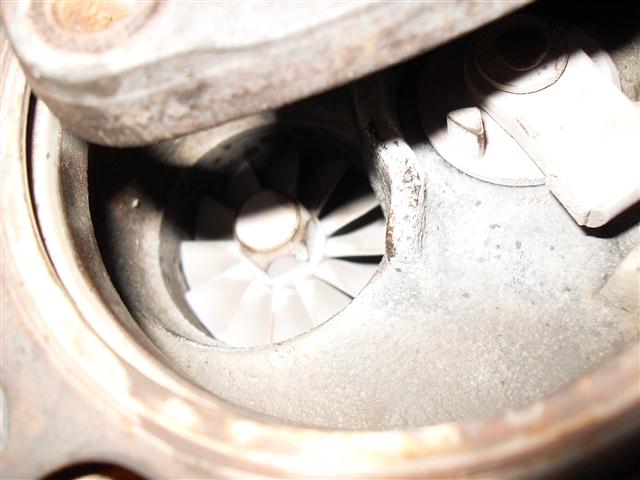

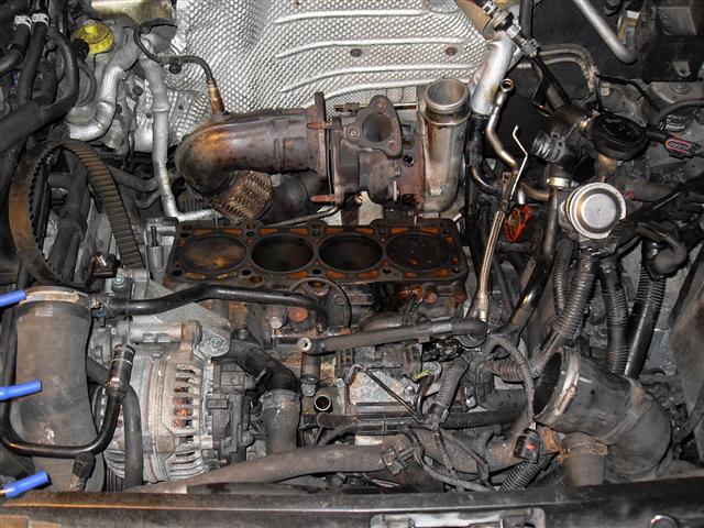

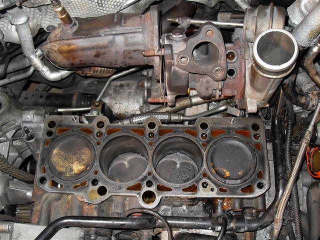

    Evening ladels and jellyspoons...
    Well, work has commenced on the project motor.
    Took it out and logged her.... Requested boost... 0.7 Bar. Actual boost. 0 Bar.
    Disconnected actuator pipe and retested. Exactly the same.
    So. Got back, and removed TIP. Span blades cold side and there was resistance at a certain point which seemed odd - almost like something was jamming the blades hot side. I forced the blades past this point and then it began to spin freely. However there was MASSIVE amounts of play in the shaft. Way, way, way more than I would ever be happy with.
    So, that got me decided that the turbo has got to be changed. I won't do half a job on it, so off it comes!
    Anyway. After logging and fannying about doing this and that, I started the head removal at about 9. Had it off by 10.30 and I must say that the engine is in FANTASTIC condition. The head is clean as a whistle. Very impressed. It's also had a new Chain Tensioner recently.
    Anyway, all the turbo pipes are loose now, downpipe is disconnected, but the sodding Turbo Support Bracket is giving me grief. Again. I hate them!
    Inside the hot side of the turbo is clearly visible, and has obviously gotten excessively hot. The entire inside is coated in whiteness! Never seen one like it. Took a photo for posterity! Will be interested to inspect it fully once the turbo is clear of the engine.
    So - new turbo will be ordered tomorrow and will hopefully turn up on Monday - or Saturday if at all possible.
    Photos from this evening:
    It really is that white!
    My garage. AKA Bomb site.
    The head has clearly had recent work done.
    Homer Simpson

    oh well, we all lost our 2 bets but at least the head only takes an hour to get off
