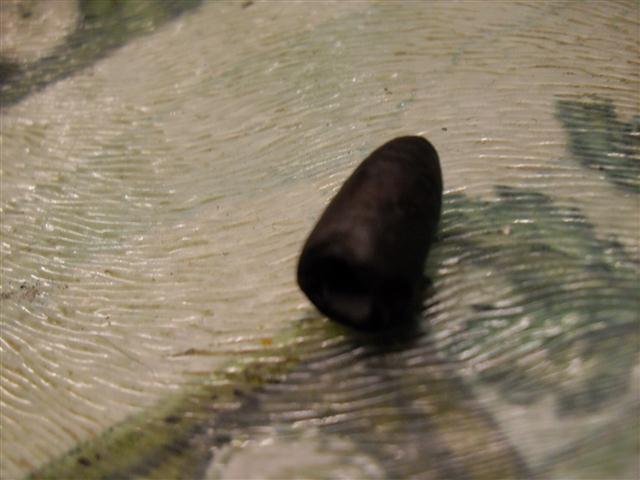

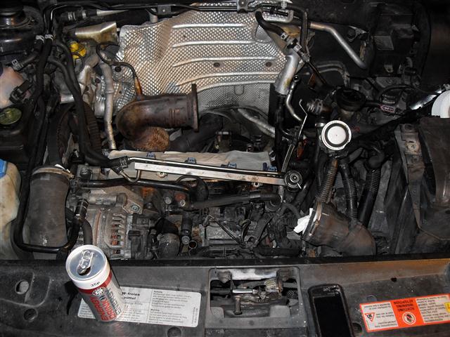

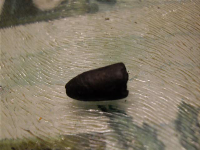

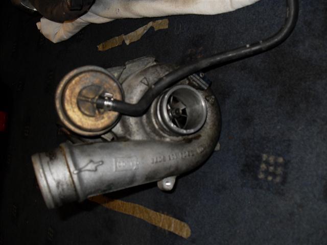

    OK, productive evening.
    Got that b*stard bolt out of the turbo support bracket by hammering a multi spline bit into it and then cracking it off. Thank god. I must admit I though the bolt head was going to have to be cut off, which I wanted avoid.
    Turbo is out and now in my garage - not looking too bad. Something (two photos below hoping that someone might know what it is!) fell out of the hot side of the turbo on removal. I'm assuming it's an integral part of the turbo. Either that or it's a foreign object which has been jamming the turbo. Also, the hot side blades are touching on the casing at one point, indicating to me that the shaft may be bent. Either way - it's ill.
    That I moved on to stealing the strut brace off of it, and fitting it to the Yellow S3. It's only temporary and will be replaced since I've ordered one off of the bay, just wanted to know what the differnce is! I haven't taken it out yet, but will report on that.
    So, just waiting to order replacement parts now and then reassembly can commence.
    Whats needed:
    K04, Banjo washers, Turbo oil return line gasket, Turbo - Manifold Gasket, Turbo - Downpipe Gasket, Turbo - Manifold Bolts, Head Gasket, Head Bolts, Cambelt Kit, Rocker Cover Gasket.
    Hopefully less than Ł500 on parts. Fingers crossed.
    Photos from tonight:
    No turbo....
    Removed turbo.
    Unknown object.
    Unknown object again.
    The strut brace I stole.....

    That random object looks a bit odd. I'm no genius when it comes to turbos but I'd hazard a guess thats whats whats bent the shaft on it. No idea what it is though, if it was the cold side you could put it down to something falling into the tip......odd because its not going to have made it through the turbo without destroying it I'd have thought?
    Well, this car has had a new engine late last year costing the owner that I bought it off Ł2500 odd. I've got the receipt. Not knowing what happened to the previous engine, it could of been in there since then....

    I think that someone was using the engine for target practice - looks like a bullet

    looks like a bullet
    I thought that actually!! Great minds....

    In my honest mechanical opinion, that piece looks like a finger from the morgue. Lol, thats the first thing that came to my head.

    Like Peedman says, I was thinking exactly the same about the fingers! Either that or it's one of Hannibal from the A-teams Cigars...
    Having rebuilt a few turbo's can say for sure it's not an intergral part of a K04 turbo...What's it made out of?
    Yeah, I don't think it's a K04 part either. It's made of metal I think, but I couldn't find my magnet to check! The piece is about 6 mm in length and 2 mm wide.
    In the words of Terry Tibbs, 'Fack knows'. Weird though!

    Thats defo a bullet lol, maybe the guy who had it before you wasnt getting stressed trying to find out what was wrong with it and shot it haha

    I'm going to second the finger tip suggestion but it looks like its off a mummy or something...they dont go that colour in the morgue!

    i think THE OBJECT must have started out in the turbo. can you imagine the mechanical mayhem that it would have cuased it if had had to pass through the engine at any point?
    is the wastegate mech all still in tact? ive heard of the waste gate penny dropping off before etc

    Turbo, apart from shaft play is in A1 condition - no cracks at all.
    I thought the same, it must of been in there. There is no compressor side damage meaning it hasn't come through the engine. Well, not through the air filter system at least!

    Can you get the turbo refurbed to save you some pennies?...new shaft etc?.
    Na....
    The reason being that this turbo is in really good nick. I want to keep it to send in as an exchange item when I get my turbo Stage 4 hybridsed......
    That's a plan so cunning you could pin a tail on it and call it a weasel....

    Well, since there is nothing else to do to the motor until parts arrive I thought I'd get the little one to test out the steering and gear linkage.
    She confirms that both are fine.

    OK, good news!
    I won that recon turbo on ebay for the starting bid of Ł249. BARGAIN!!
    Will pay for that today and get it here this coming week which will be good...
    Link to the item is here: http://cgi.ebay.co.uk/ws/eBayISAPI.d...#ht_894wt_1165

    Has the turbo you removed got an EGT probe? if not you may need a blanking plug for the turbo you have bought if it is indeed from an AMK S3 as they have EGT probes
    <tuffty/>

    Quote Originally Posted by tufftybloke View Post
    <tuffty/>
    No matey, no EGT. It's an identical turbo part number....
