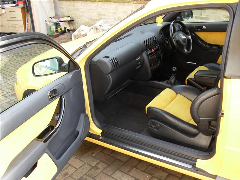

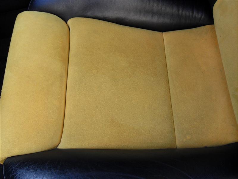

I broke out my new de-bobbler (as introduced to me by Tuffty :icon_thumright:). I de-bobbled all of my seats, which had 125k's worth of bobbles. That may of taken a while.... Looks a million times better now though. I need to get a steam cleaner to clean the seats now, and the interior will be sweet.

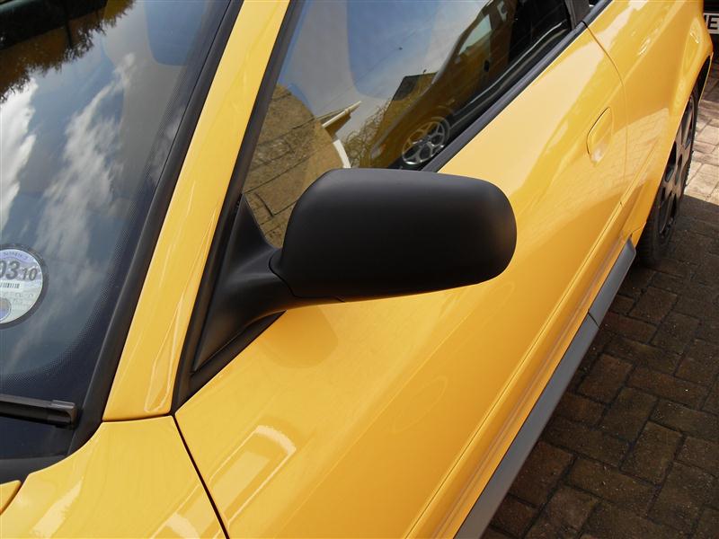

So then I whipped the mirror covers off and did them in matt black. The drivers one got hit the other day and had a crack in it, which is the main reason for painting them. A bit of Isopon both sides, a sand and several coats of black paint gave me the desired effect.
Mirrors now match my matt black wheels :). I went for matt black to be different. Chrome would of been nice, but the S3 has a very yellow and black theme so I thought I'd stick with it. Looks good I think.

Bit undecided on the mirrors though...I think they would look better gloss?

...I broke out my new de-bobbler (as introduced to me by Tuffty :icon_thumright:). I de-bobbled all of my seats, which had 125k's worth of bobbles. That may of taken a while.... Looks a million times better now though. I need to get a steam cleaner to clean the seats now, and the interior will be sweet.
D00de... don't steam clean alcantara... the fibres will just fall out and it will ruin it...
Use a weak mix of something like Maguires all purpose cleaner, spray it on a micro fibre cloth and wipe... don't soak the cloth at all... repeat this a few times and it should all come up clean...
You have to be real careful with alcantara mate...
<tuffty/>
<tuffty/>
Good advice there dude - loving your work. I didn't actually mean a steam cleaner, what I meant was one of those Vax wet vac things.... But by the sounds of things, thats a no no also.

Not sure on the mirrors, matt black makes them look like there unpainted black plastic. Has the clunking gone away? I like the de-chromed surround but I think I would of kept the rings chrome
