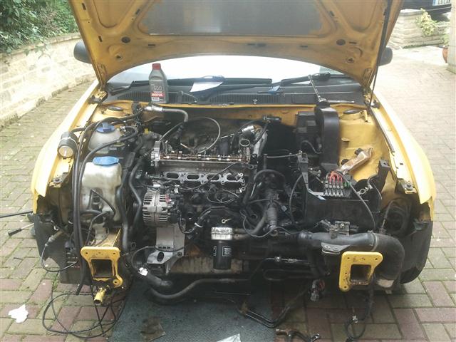

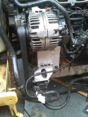

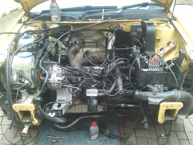

    OK, big update here from the weekend.
    The upshot - it works.
    Started Friday night as I said before with getting the block back in and hanging on it's mounts. Even with the front end off, not an easy job as the bloody engine into the box is tighter than a gnat's chuff.
    Got that in a happy with the new belt on ready to fit and decided to pack it in for the night as was 10PM and getting dark. Also my Mum now runs a Bed and Breakfast and there were people staying so couldn't stay hammering in the garage until stupid o clock like last time annoyingly.
    Back on it on Saturday afternoon once my nipper had gone back to her Mums. Went down to the local Motorworld (lush) to get some cheapo oil. Managed to get some 10w 40 Mineral and 10w 40 Semi Synthetic from there as well as a few other bits and bobs.
    Then on to the local hardware joint to get 6 x M6 bolts to replace the rocker cover studs. This was for 2 reasons. Firstly, the on closest to the turbo is a problem as it's too tall and you can't wind a nut onto it when the turbo is there. Secondly, UK mail must have dropped the head in transit (****ers) and bent some of them.
    Then made my way up to the car and made a start.
    Started like this on Saturday:
    Then this:
    Then the head went on complete with turbo:
    Anyway, so the head is on and timed up by this point so I was interested to see how my planned aircon delete was going to work.
    Fitted the bottom pulley, and then the tensioner. Belt fits like a glove basically, really pleased with how well.

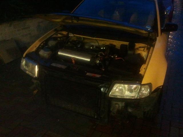

    Left the car like this on Saturday night when rain and lack of light stopped play. So close to being finished it was annoying...
    Sunday morning got up and got to the car early. Filled with fluids and it was fluid tight which was a massive bonus...
    Fitted the remaining engine bits and bobs of which there weren't many, mainly charge pipework and various other little bits and bobs.
