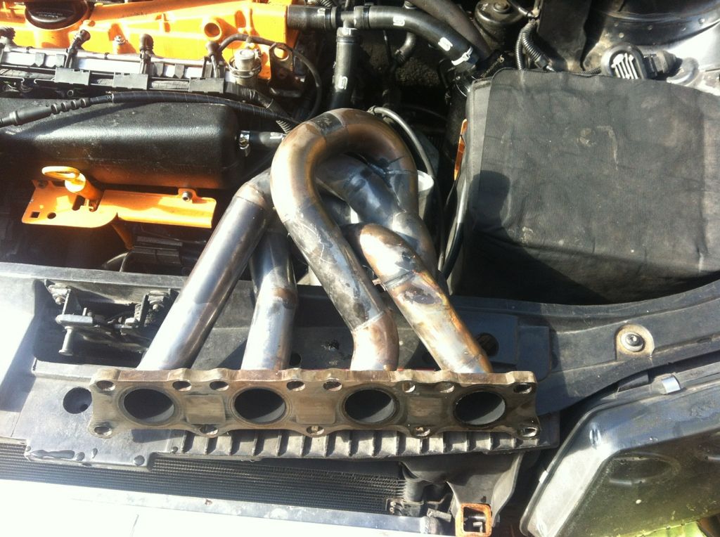

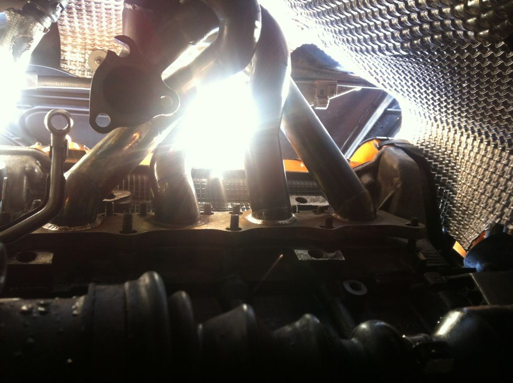

    Finally got the last of the evil nuts of doom removed, and by 10am, the manifold was off!

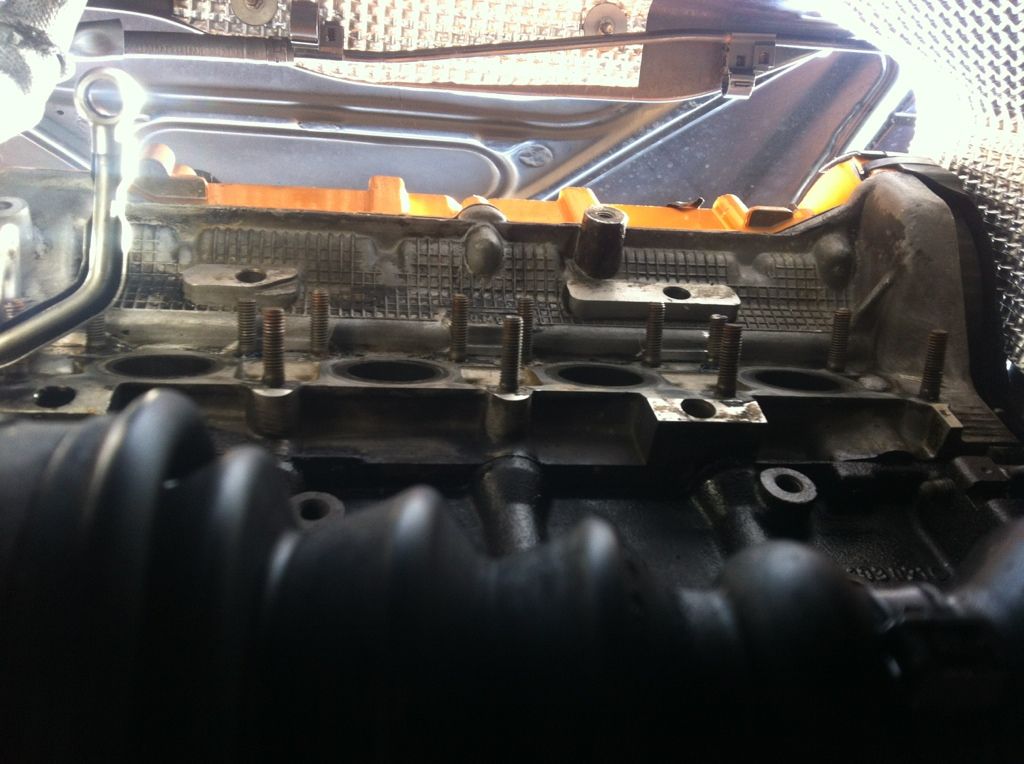

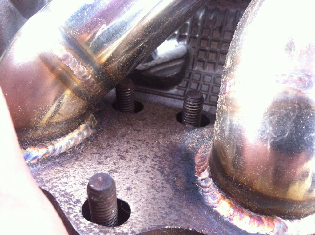

    An issue that was mentioned to me when Rick built Sam Bryants engine, on the V2 manifolds one of the exhaust studs actually hits the runner on cyl 1, and stops if from tightening down properly:
    Still not perfect then XS!
    Simple solution though, just grind down the studs at the two tight locations. I whipped the studs out to do it properly, and ground them down and recut the threads, then wound them back in with thread lock, you can see the short ones in this pic:
    Brand new nuts again, and of course the Nordlock washers
    New gasket in place, and I bolted up my shiney new XSDave:

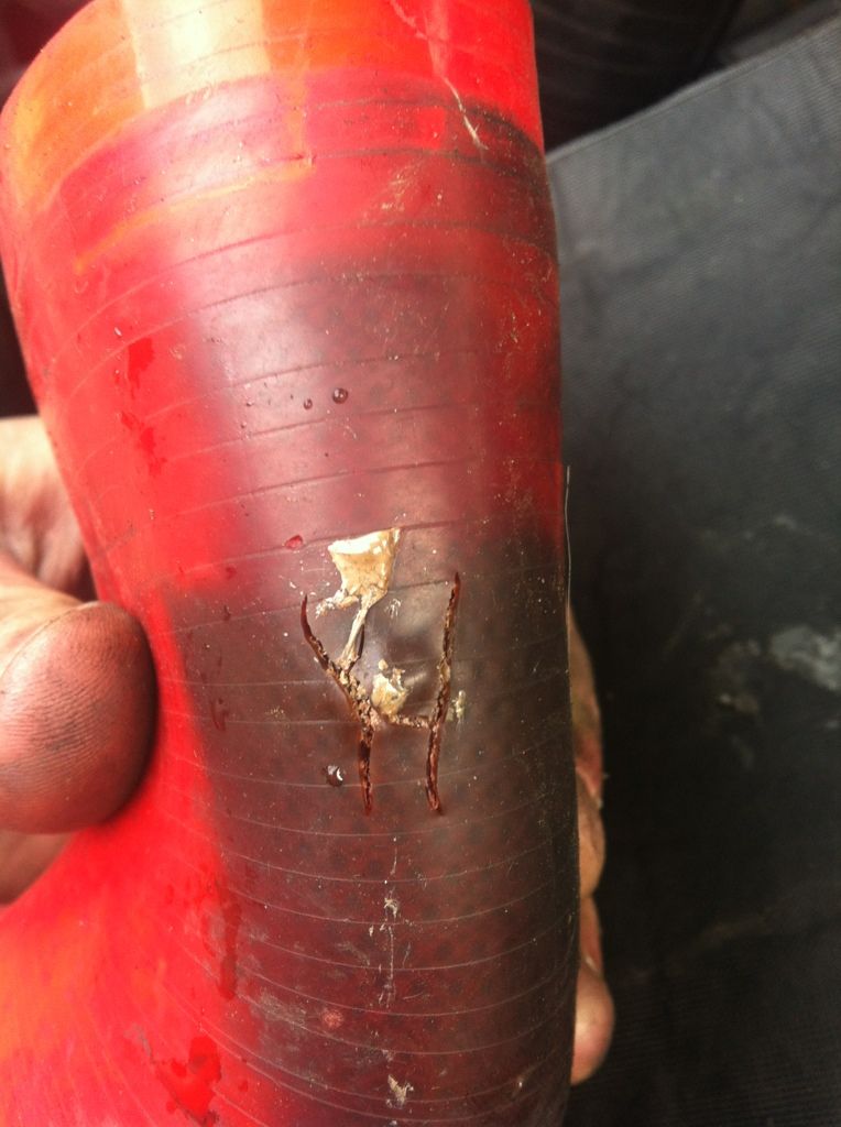

    After I blew the hose at Rockingham, I bodged on a hose I borrowed from Andy, not the right size, but it worked. This hose has been on the car for just 200 road miles, and I think one track session on actuator pressure.
    You can see how the heat was already effecting it here:
    Give it a squeeze and it gets a whole load worse!

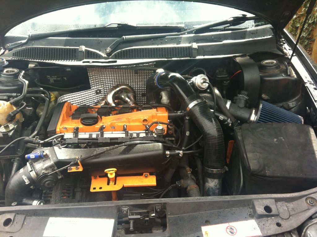

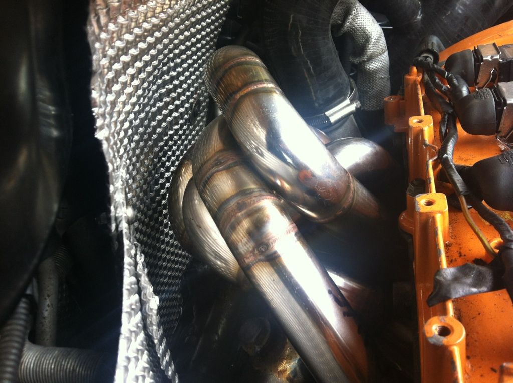

    Everything back in and slotting together nicely, and it's alive!:
    About 5-10mm more room behind the V2 manifold compared to my V1 before:

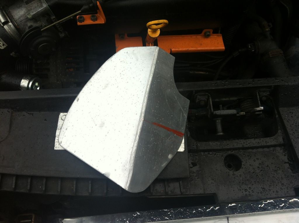

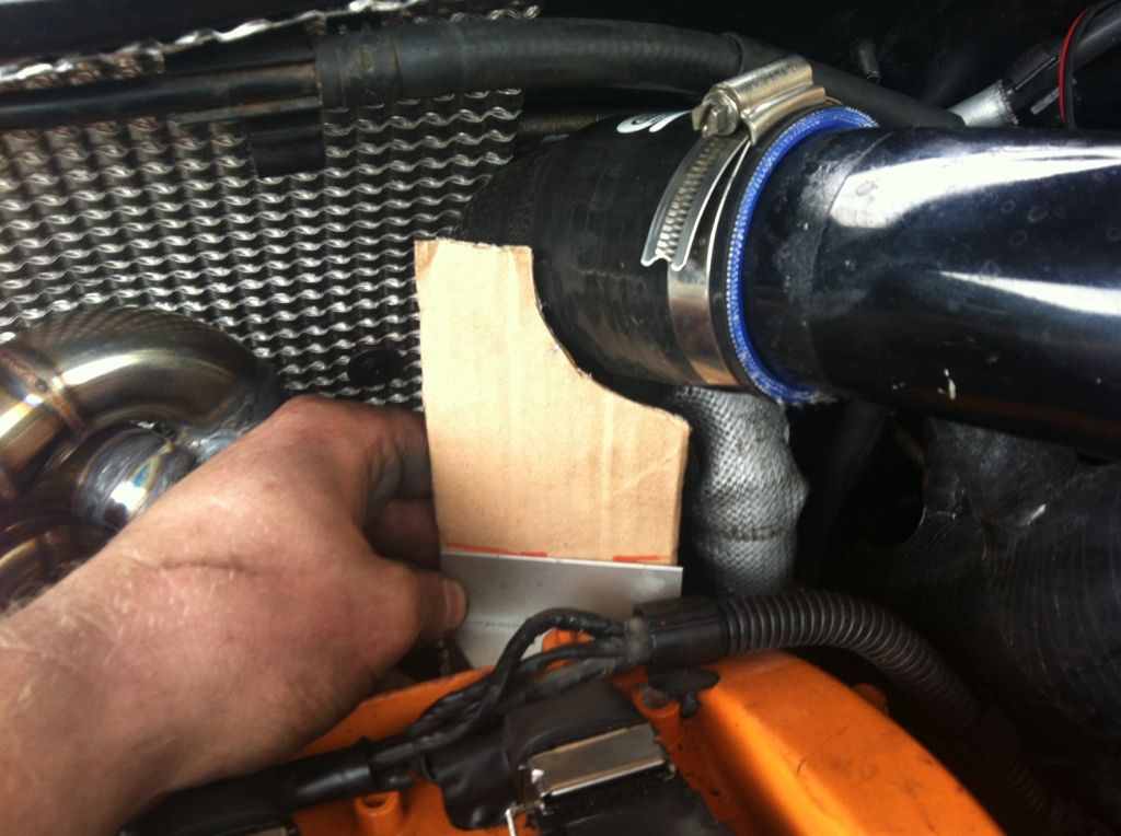

    Time for some more CAD to get this heat shield under way:
    30 mins later after plenty of filing and triming, I came up with this rubbish looking bit of plate!
    All will become clear when it's in place, it actually looks quite smart, but it's raining again, so it can wait!
    Manifold already turning several shades of gold after just 5 minutes running

    Well done bud. I know how difficult it is to work on these manifolds with the engine out let alone with it all in the car

    Right, GP is over, rain has stopped, might finish this heat sheild quickly and get the bumper back on!

    The stud you had to cut, isn't so much of a problem with the head off the car as you wind the nut on with the manifold slightly off. I have to say having done it with the head off, fair play for doing it while still on the car.. Patience of a saint!
  12. #1811
    Prawn's Avatar
    My other car is a MINI!!!!
    Offline
    Join Date
    Dec 2006
    Basingstoke
    Posts
    9,361
    The stud I cut will still be an issue with the head off Dan, as it's too long and the actual stud hits the runner, it's not related to the nut.
    If you've done it up without cutting the stud down I can garantee that the stud will be gouging into the runner, or, worse, stopping the flange from sitting flat on the head.
    Having done this twice now, It's annoying, but provided you set yourself a silly amount of time ( 2 days) it's easily done at a leisurely pace.
    I could ahve finished it in a day easily, but I like to take my time and take pics along the way, plus I have to answer the constrant stream of phone calls, either Dad wanting to buy more tyres, Jardo trying to send me more pics of his clio, or frenchman sitting in his room in oz with sodd all else to do but talk about his new car he's just bought from me :P
    Right, post GP progress, bumper is back on, car is ready to hit the road when I empty the crap out of it.
    Heat shield is also finished, and I'm very happy with it

    Brilliant progress mate, loving the heat shield....
  14. #1813
    ScottD3's Avatar
    Offline
    Join Date
    Nov 2010
    English Riviera
    Posts
    15,003
    Nice bit of fabricating Prawn.
    Looks good mate.
    Any chance of the heat shield hitting the pipe or bulk head when the engine moves?
    New Car, New Thread: Scott's Akoya Silver A8
    Gone But Not Forgotten: Audrey's Build Thread
  15. #1814
    Prawn's Avatar
    Offline
    Join Date
    Dec 2006
    Basingstoke
    Posts
    9,361
    Shouldn't be Scott, there's a constant 8mm gap between the shield and the silicon pipe, and both are attached to the engine so will move together.
    there's also a 15-20mm gap at the back against the bulkhead heat shield for that very reason, although in the pics it looks more like a 5mm gap! I was watching very closely on Bills dyno how much the engine moved under full load as I wanted to see if the manifold touched the heat shield. it was ULTRA close on the V1, but the V2 has much more room at the back and now there's no chance of it hitting

    hmmmmmmmmmmm, nearest meth bloke on ebay is about 40 miles, and £23 for 25 litres. doesn't sound too bad. Will consider it.
    Took it for a drive this evening, only a few miles, but it felt SOOOOO good, going from a 110bhp focus tdi to this, even on actuator pressure it just feels amazing in every way.
    Suoer happy with it right now
    Pic of heat sheild clearence for Scott:
    I love the colours the manifold goes through when first fitted
    And the pic I had to send Bill after I did a horrendous job of trying to explain what I wanted on the phone! Thanks for putting up with me Bill

    Was Bill happy with the boss location just before the bend? I know there's a bit of a knack with where to position the wmi nozzle so it's bang in the airstream.
