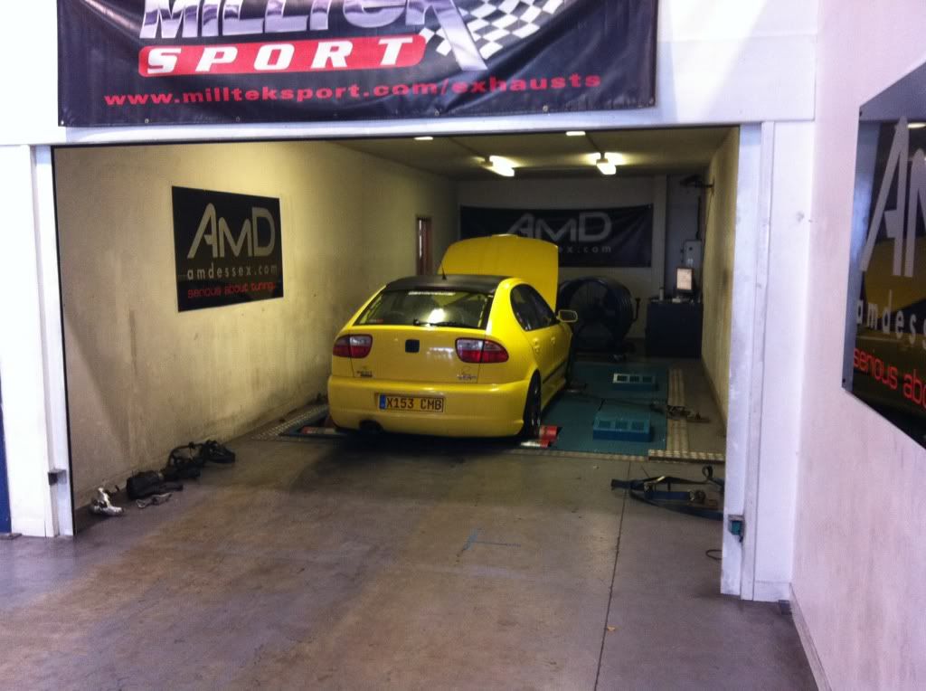

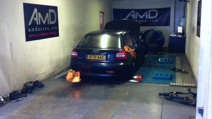

    I know there are various suggestions going round that the AMD rollers are a bit on the happy side, but I know that, so take the figure with a pinch of salt, but still, it's nice to see good numbers come up!
    We left in the pouring rain, and my new single wiper got thrown in at the deep end!

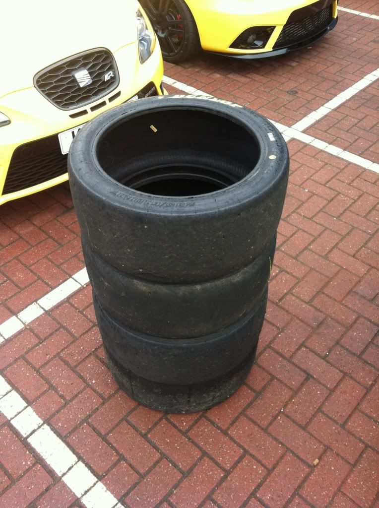

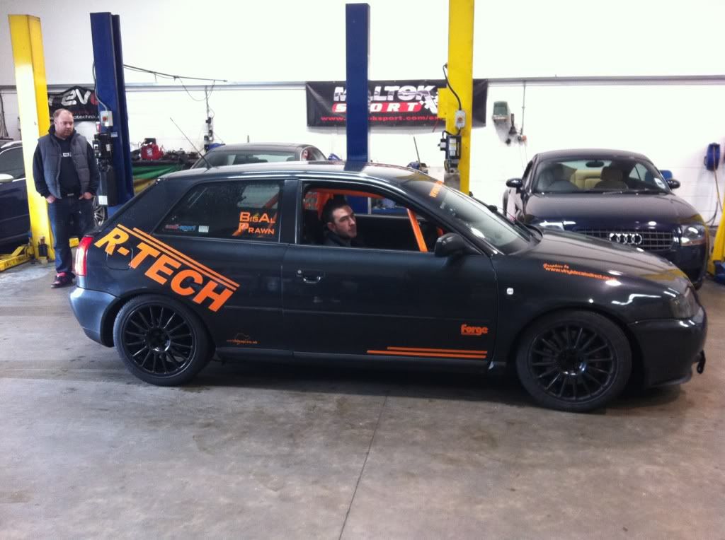

    The day started out pretty well with a getting a set of Dunlop slicks from the AMD BTCC touring car:

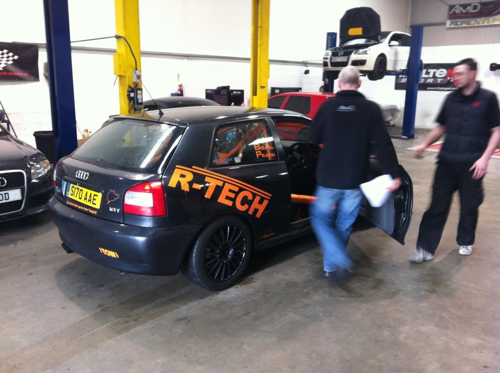

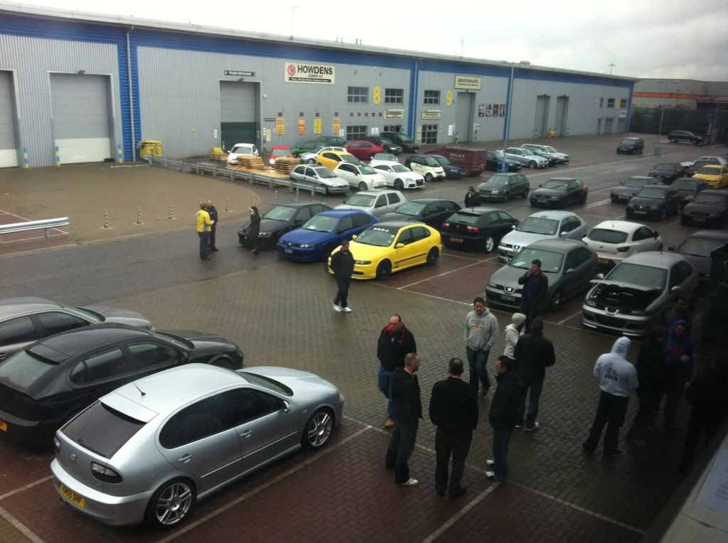

    Then the fun started, plenty of cars there, probably 35-40 cars on the rollers today! Around 11am, it was my turn!
    Yes, I might have gone a bit nuts with the stickers! A bit of advertising for Nick in return for excellent service and support, and partly because it just looked a bit boring all black!

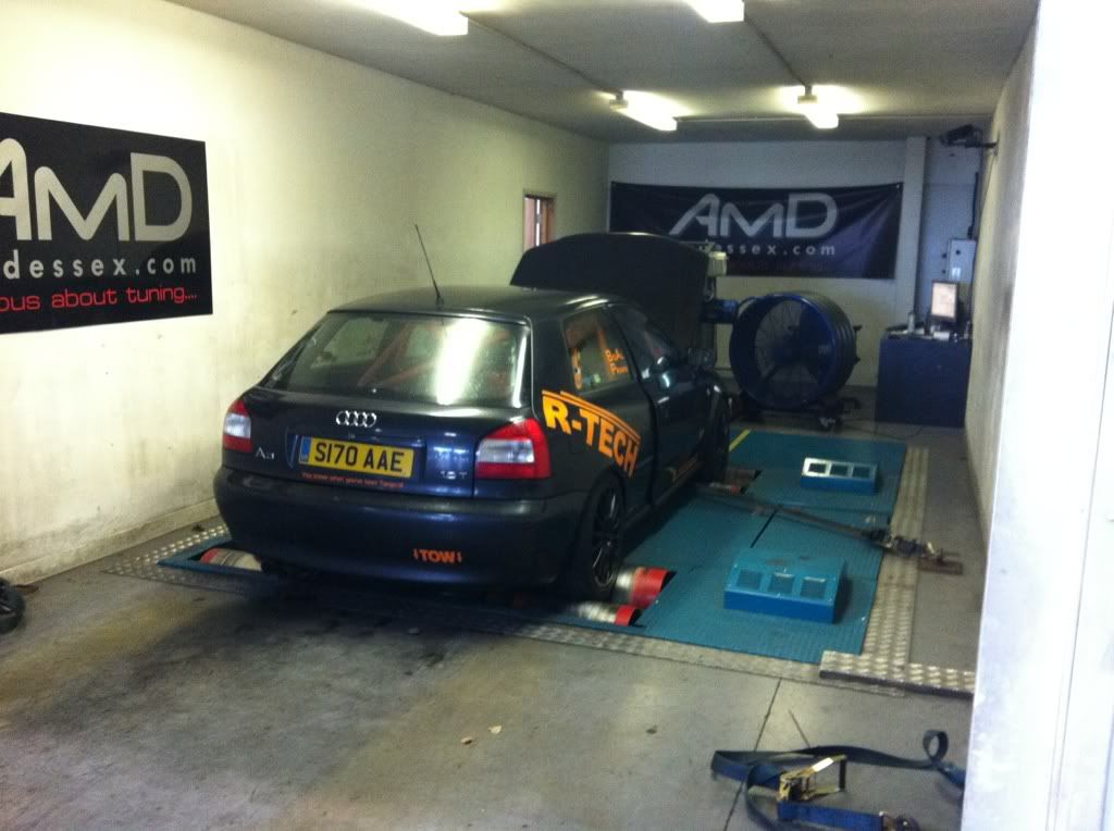

    Onto the rollers it went:

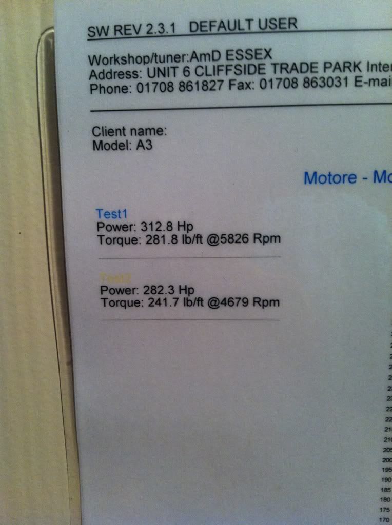

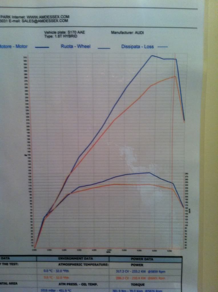

    One run was done on full boost, and one on actuator pressure, then the dyno PC crashed before I got the results! ARGH.
    So, it was all repeated again:
    Very happy to see 313bhp and 282lbft with the N75 plugged in, not bad considering this is still the de-tuned map.
    Nice flames on over run too!
    Even more surprising though is how well it goes on actuator pressure only, around 12psi of boost produced 282bhp and 242lbft! Even with an optimistic dyno I was very surprised at that. No wonder it goes so well!
    I wired a switch in yesterday, so it's easily switched between actuator pressure and full boost:

    Plenty of people there!
    Heading home:

    Scanned in the dyno plot from yesterday.
    Even if the figures are slightly inflated, the shape of the curves is bloody lovely!

    so 291bhp @ r-tech equated to 312bhp @ AmD?
    same settings boost wise?

    Yup, I was hoping you would show up to post your famous Dyno lottery picture Bill!
    Pretty much exactly 20bhp/20lbft up on R-tech figures on both actuator and full boost, identical settings, all N75 controlled on the full power run. I'm not using the ebc any more.
    Just one more well known set of rollers to try it on now!

    Posts
    1,695
    Looks like a great day mate! Some awesome pics especially the one of the flames. I heard that AMD had happy rollers but 20bhp is being too generous?
    lol
    indeed..
    brace yourself for lower figures here
    where stock turbo k04's make >300bhp you have to wonder.. hmmmm
    maybe we will see a 300bhp k04 car here when some of the ones with high flow exhaust mani's come thru which are being done.
    285bhp max thus far I have seen from k04
    should be interesting
