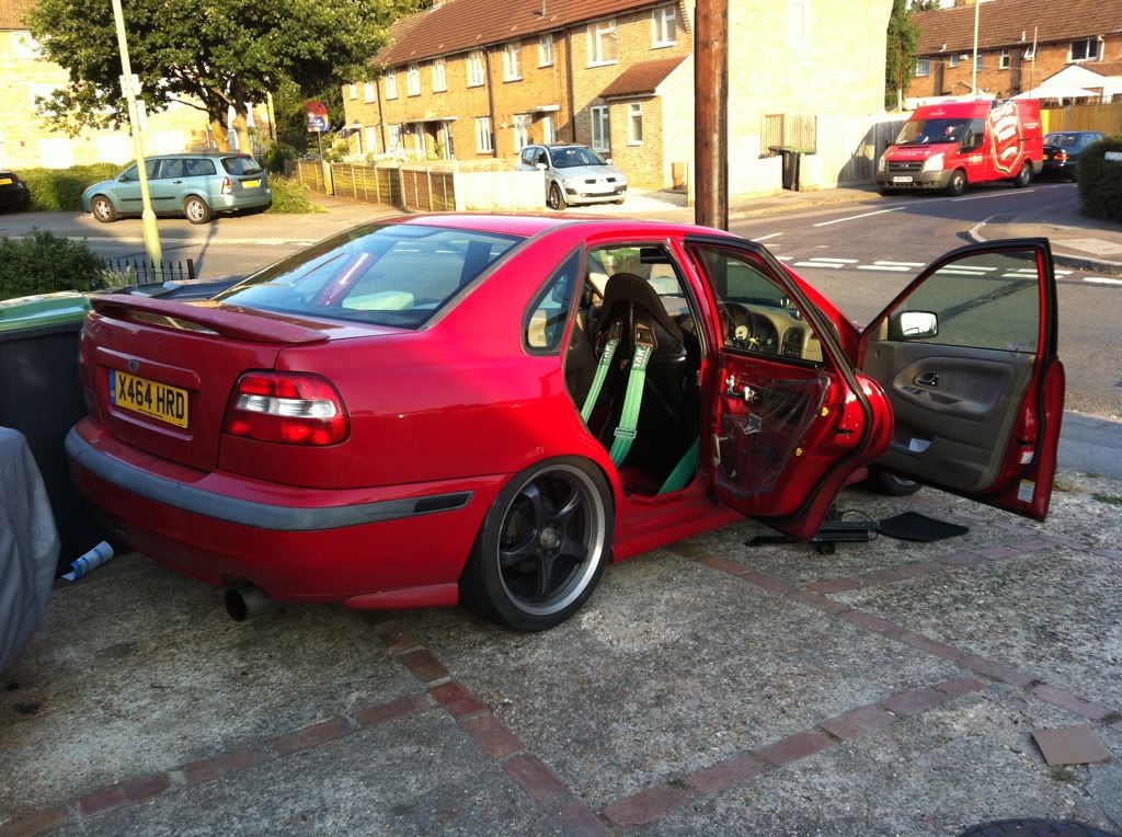

    There's a nice array of cars on Andys drive, including this:
    His housemates 440 bhp Evo 8 mr fq340
    Then there's this:
    Best value for money car on the planet! £500 for a 250bhp s40 t4, with Evo brakes, coilovers, buckets, arbs, it's bloody awesome! And being built solely for our ring trip
