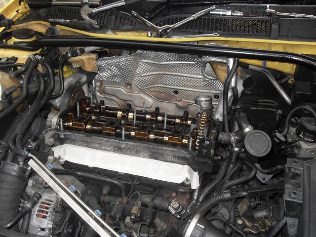

    OK.... kicking off Monday AM went a bit wrong.
    Dropped my engine flush in earlier on, and then dropped out the oil and am leaving it to drain overnight...
    Then I thought I'd just take a few bits and bobs off.... and then that turned into taking most of the bits required to remove the head off...
    This is how I am leaving the engine tonight ready for the final bits tomorrow...

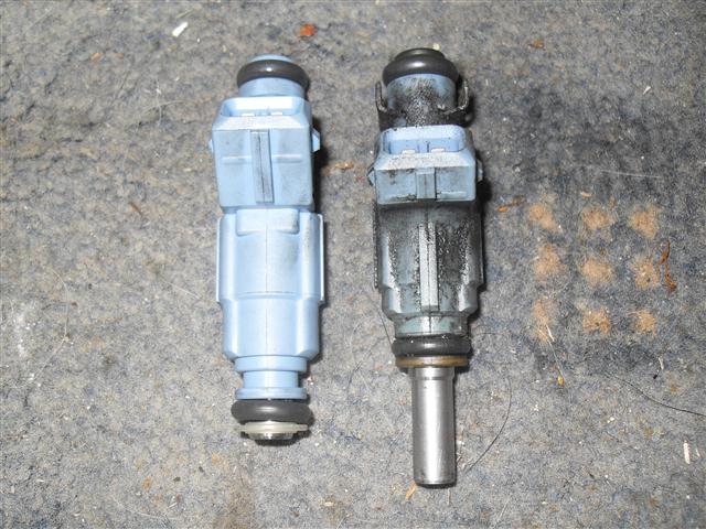

    VXR Injectors vs. S3 Injectors.
    Random dead wasp I found in the recess between inlet ports on 1 and 2.... Thats new. Must of thought my car was it's mummy....

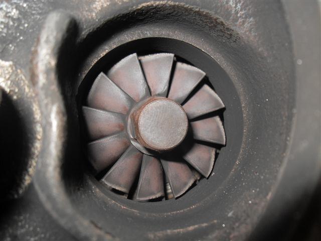

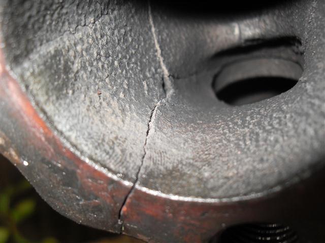

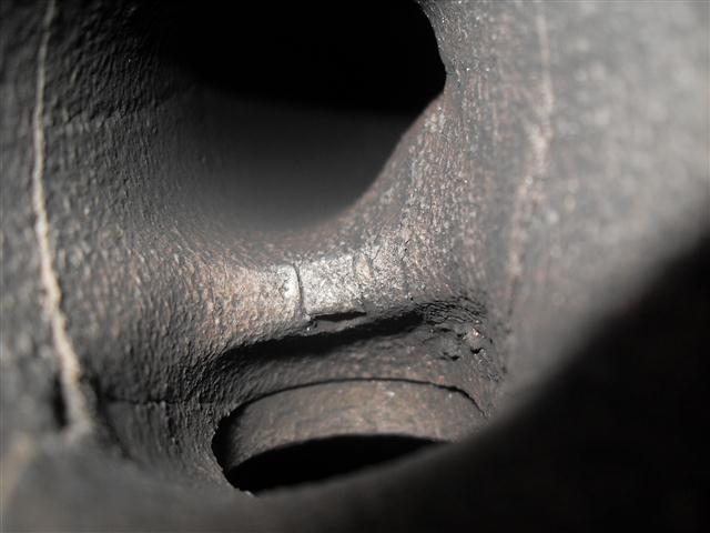

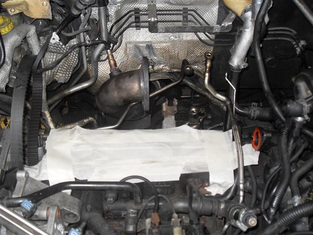

    Eventful day.
    All my stuff ordered from Euro Car Parts has now arrived which is a relief....

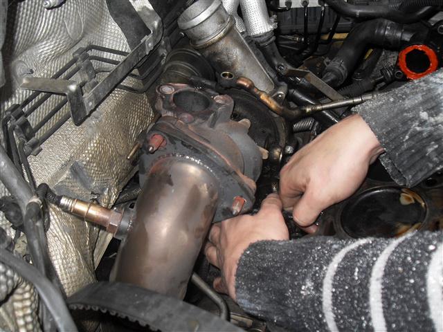

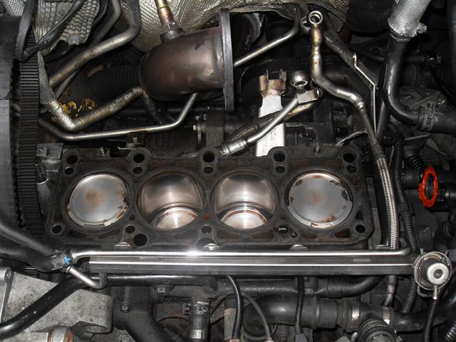

    Much as you'd expect though to be honest. Got the head and old turbo off in about an hour as I did half of the work yesterday.

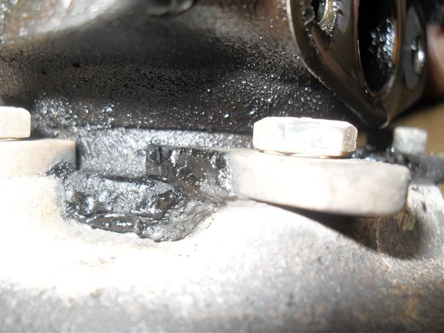

    Lots of oil floating about in the pipework, inlet manifold, various other places where oil shouldn't be really. Other than that, lifting the lid off was uneventful. Head gasket was A OK which was good, and has now been placed in the circular file, along with all the other gaskets etc.

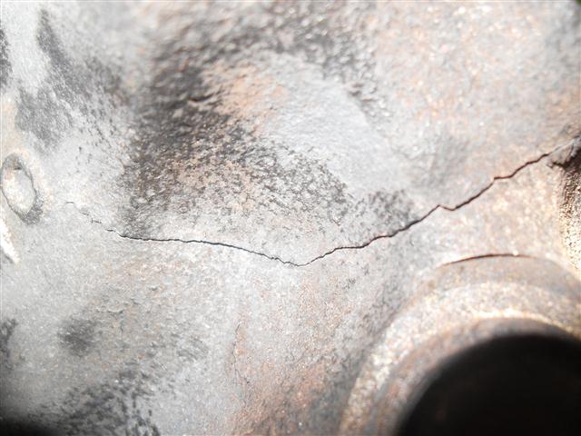

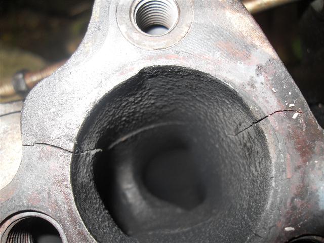

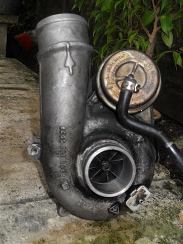

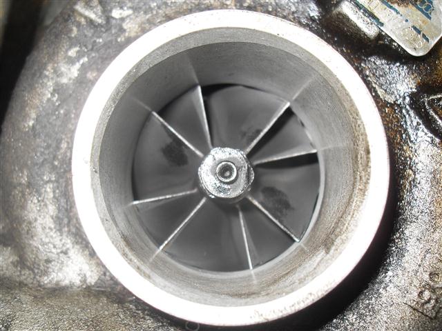

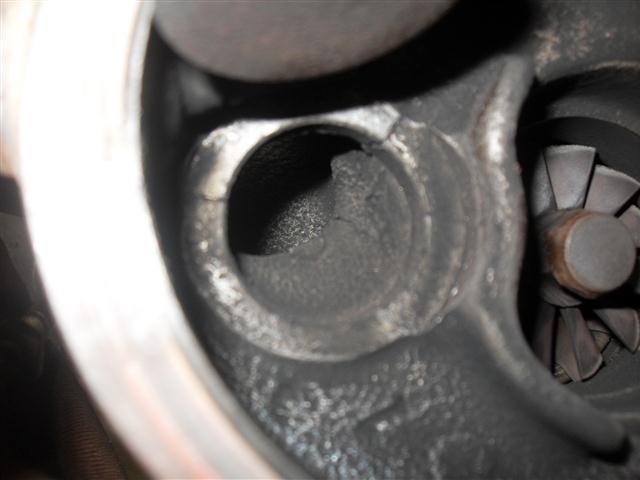

    The turbo wasn't in the best nick.... And that's being kind. Photos below show the damage and the severity of the cracking through the hot side.
    Comp and turbine wheels look to be in OK condition, however the amount of play in the shaft is awful. Literally has about 2-3mm in and out play on the shaft, suggesting the core has collapsed.

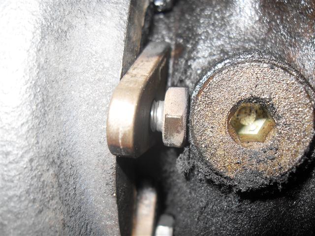

    Have also found various other issues with it - the actuator is shagged. Totally. One of the bolts that holds the turbo together has come loose, and is where my oil leak has come from, allowing oil to leak out and down the back of the engine. Again, this is obvious by the amount of cooked oil around the join.
    Other than that, everything is cool. Some slight detonation marks on the piston from where oil has been getting in and been getting burnt. The pistons were pretty crusty from oil contamination. I've given them a quick clean up, but there isn't much point in going too mad.
    By 1 PM we were getting bored and were trying to do stupid stuff like make the turbo boost using a high RPM drill. Epic fail . Fun though.
    Gave the engine bay a good clean up, got all the crusty oil off of all the back of the engine.

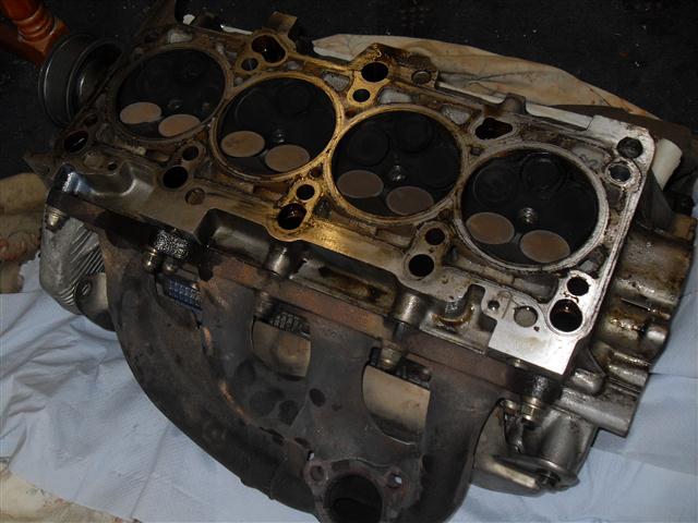

    Cleaned the head, got all the remnants of old head gasket off of it.
    And to be honest, that's it for the day now, nothing more I can do until the Hybrid arrives from CR.
    Now retired to the lounge to while away the rest of the day posting up here, and playing on COD. Ahhhhh.
    Anyway - to the photos....
    Starting the day....
    Damn Turbo Support Bracket.... It's SUCH an arsehole.
    Turbo off.
    Poor old thing - not looking it's best.
    Turbine & Compressor wheels.
    Damage to the hotside.
    The bolt that decided it didn't want to be tight anymore, and the crust of oil from the leak resulting leak.
    The head.
    The engine bay after it had received some love....

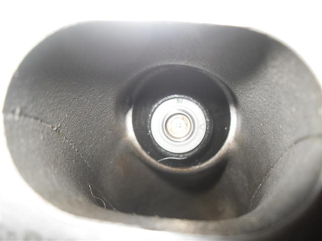

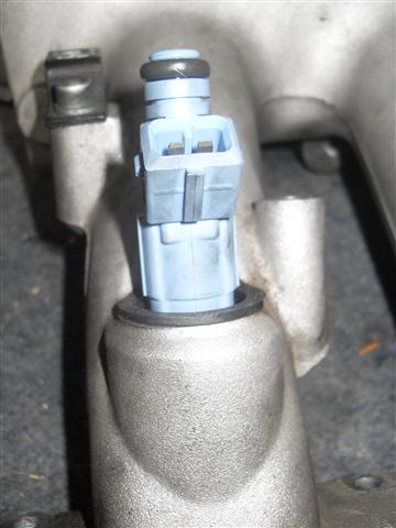

    S3 vs VXR Injector
    VXR Injector fitted to S3 Inlet Manifold. The injector is a great fit into the manifold, and the shorter nose should help with better fuel atomisation, as well as not impeding air flow through the manifold.
    Thats it for today... all I expect to see for the rest of the day is something similar to this....
    More tomorrow....

    the gap around that turbine wheel is huge... some serious erosion gone on there...

    I'm going to bring it up to show you tomorrow night dude, the thing is poorly - but good to have a bit of a laugh at. This one certainly wouldn't be a hybrid candidate...

    Evening all...
    Another long, yet productive day today. It started at 8.30 this morning when, out of the window, I saw a FedEx van turn up. After a brief jump around session I went downstairs to greet some miserable twat with my new turbo...
    So, I got it out and drooled all over it.
    So I set about having some brekkie and faffing about doing this and that around the house until my mate turned up.
    So, then we cracked on. As you will have seen, I had to pop up to Bll's at 12.30 and take he turbo with me for him to test the actuator preload. Therefore we couldn't start fitting the turbo until after this.
    So, the fun job of installing new water pump, belt tensioner damper and removing the engine mount to fit the new belt round. This was made massively easy by figuring out that, with the head of, you can slide the engine mount out of the engine bay from the top, rather than the bottom. Took about an 80th of the time it normally does.... Welly's Top Tip for the day....
    Anyway, photos below:
    Cambelt area with nothing in....
    Old belt components.
    New vs Old tensioner damper.
    All new components fitted.
    At this point, rain stopped play, and we had to leave to get to Bill's anyway.
    So, once back from Bill's (Thanks for meeting me at lunchtime dude ) at about half 1, we cracked on with fitting the turbo...
    Did all the prep work to get it on, such as winding the turbo studs into the turbo, and then fitting commenced.
    Turbo support bracket fitted.
    Turbo all bolted up, with all oil lines and coolant lines.
    Then, on goes the head...
    Timed up...
    At this point, I popped off the piping to the intercooler to see how much il the old turbo had dumped in there...Quite a bit was the answer.
    VXR Injectors fitted to the injector rail and fitted to the inlet manifold
    My Billy Bodge to get the rail o fit with the different sized injectors...
    Engine back together and running... Happy days.
    So, the engine is back together and running fine.... So far anyway.
    Need to do a few bits and bobs of tidying up tomorrow during the day, and then the hardware install is all completed.
    Up to Bill's on Saturday AM for first session of mapping - I cannot wait.
    Will post results of first drive up when I take it out tomorrow as well, hopefully with logs.
    Nearly there....
